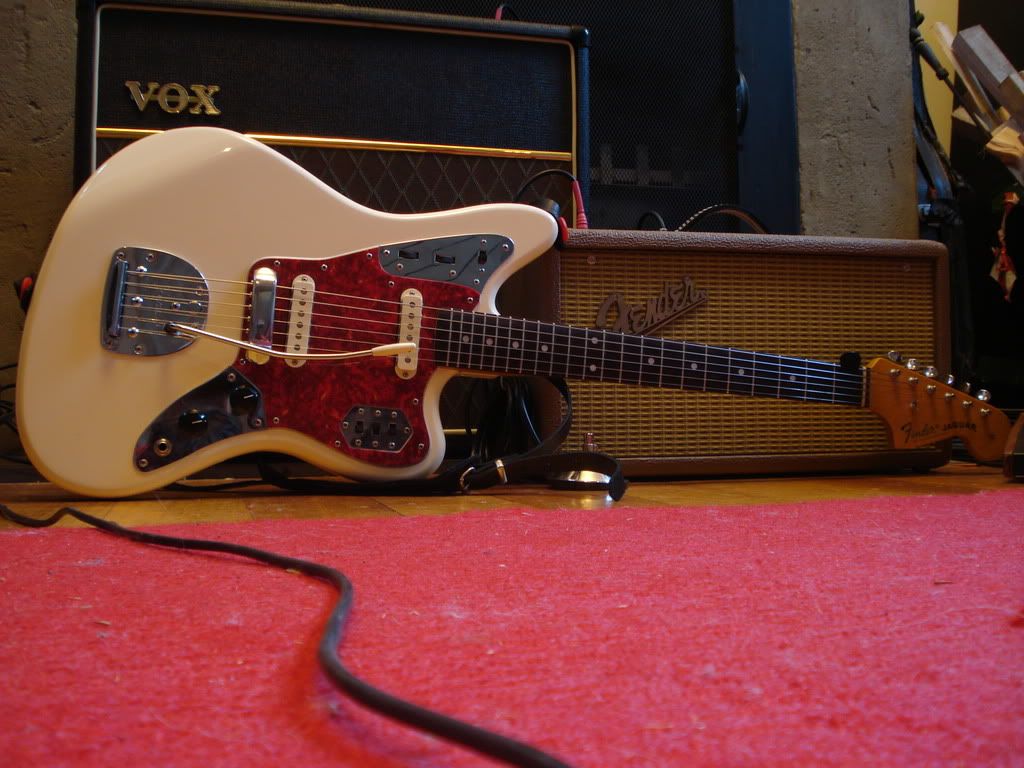

Thanks guys. That's really interesting.. I had a loan of one of these below (fender tank) for a few months and I may have fallen in love with it.
I think it may be the only way to go...eventually. They sound bloody fabulous.

Fender outboard unit is cool. Incidentally, I believe they are copied off of a reverb from old Hammond organs like the A-100. Wouldn't swear to that though.
