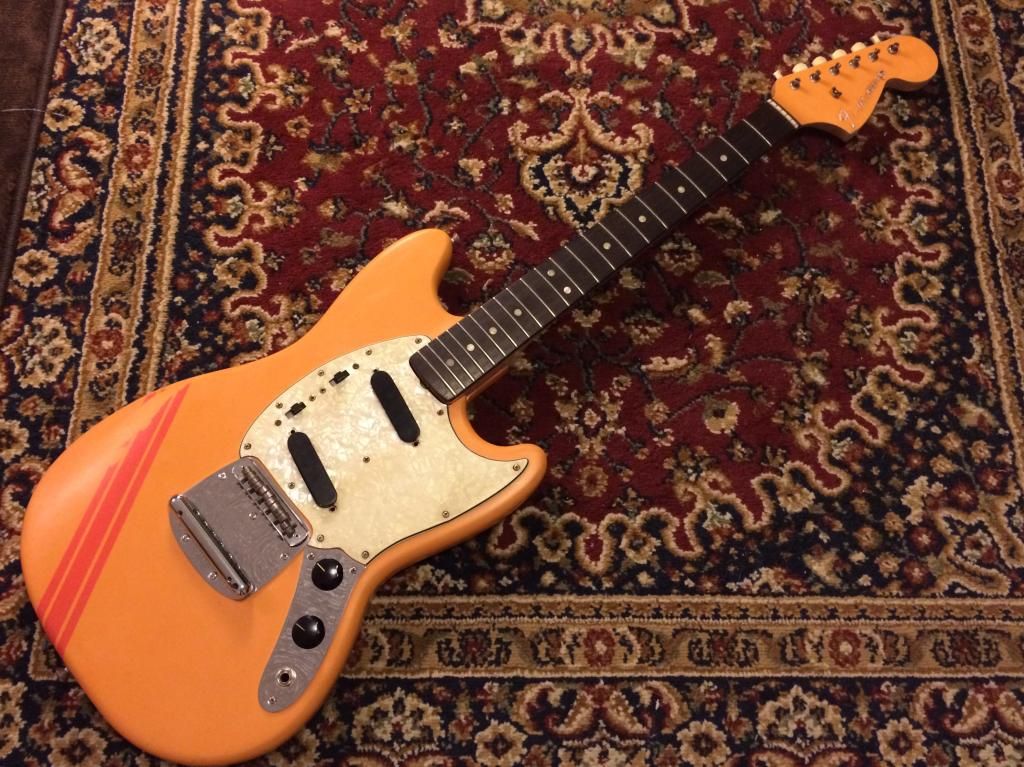

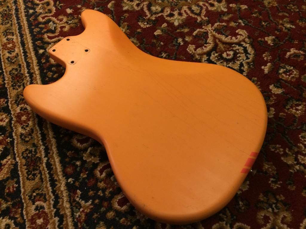

No more black. Back completed tonight, err, this morning...? Still need to finish sand it but I couldn't resist bolting it as together as I could. Still waiting on neck plate and pickups... Otherwise I would still be downstairs soldering it together.

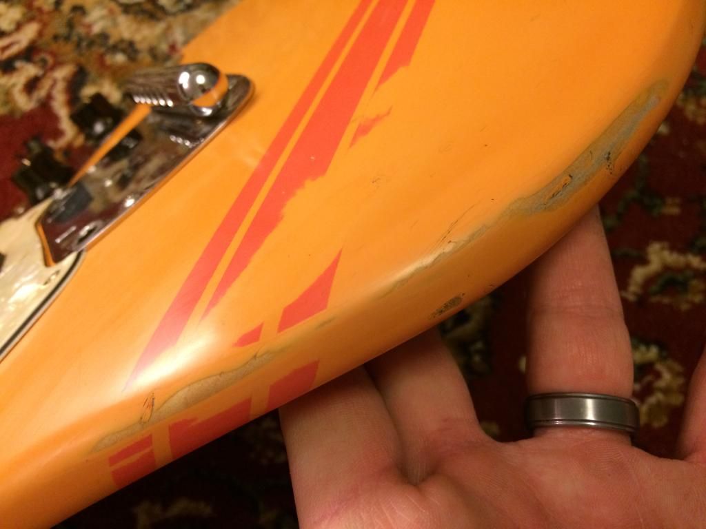

A few lacquer cracks on the back and lower side. Nicks and dings here and there. Finish is worn thru in a couple places but (other than part of the stripe) it looks to be original wear from its orange period. This thing just screams play me. Can't wait to get it all buttoned up.
I took the body (before back was done) in to my paint guy. Asked his opinion on the finish. He strongly suggests hitting it with a thin coat of clear to preserve things. Said if I play this on a regular basis id just end up wearing through in numerous parts. I'm on the fence. Kinda want to see how things look after the finish sanding. Thoughts???
da p0rn
da p0rn

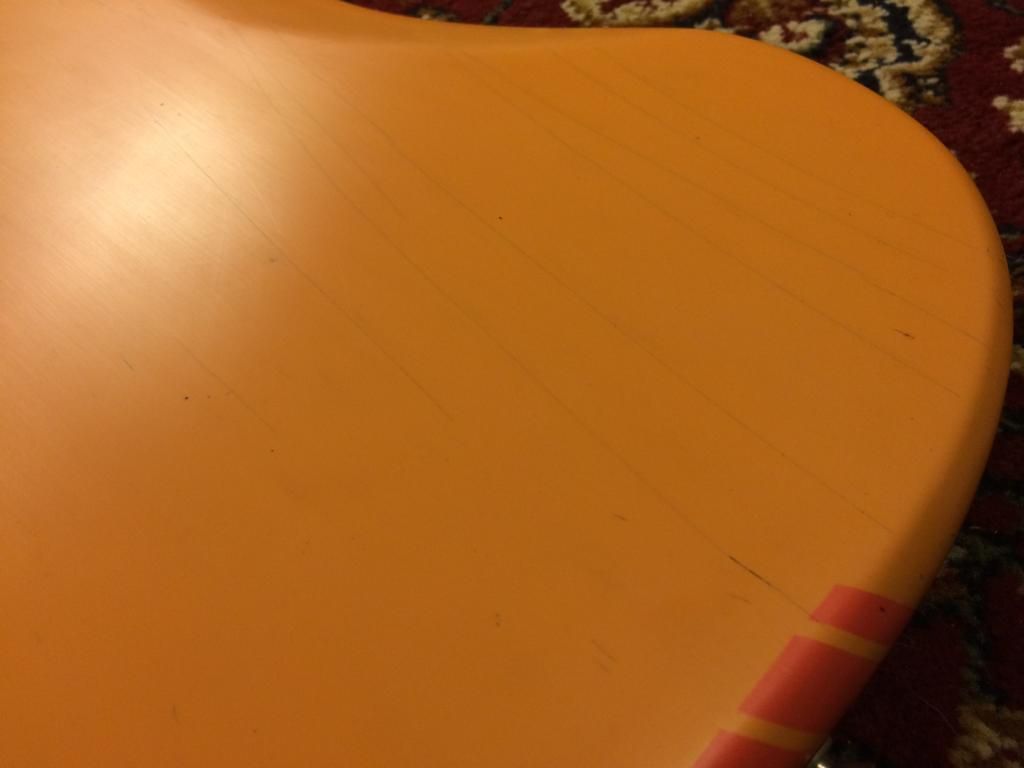

If it was mine, I'd buff it out and see how it looks first- there's nothing to lose by doing that.
Also, in this case I wouldn't sweat going through all the grades to 2500 and beyond (you're at 1000+ now right?) Maybe just hit an area with buffing compound at the point you are now, and see what it looks like.
The reason I'd shy away from overspray is the inevitable clearcoat over visibly worn bits issue. It'd bug me on an ocd level AND probably be too shiny overall.

I'm kind of anal about these things, so I would definitely not overspray it. I don't see the point of painstakingly removing an unoriginal finish and then applying another unoriginal finish over it. Yes, the overspray is clear, but to me it's the same thing... a refin is a refin is a refin. You're looking at original Competition Orange!
As for "preserving" it, as said above... what's the point? Who cares if you come through the finish in spots, as long as it happens naturally? I mean, that's what happens.
It's clearly your guitar, your decision... but I hate to see all your painstaking work be undone (which is what it amounts to in my opinion). I'd sand to #2000 and then buff it with 3M Finesse-it until it has the deep, wet look you desire. Then I'd just play it and see what happens down the road.

Aaaaand we have a winner. Nailed it indeed. My OCD is pretty much on par with yours Mr. Plast. Stepping back, looking at the big picture a topcoat would be just like painting it black again. There's plenty of finish left to work with and buff out. Will be picking up some 3m Finesse-It on the way home today. Thank you for making my evening plans for me.apreswho wrote:fullerplast wrote: It's clearly your guitar, your decision... but I hate to see all your painstaking work be undone (which is what it amounts to in my opinion). I'd sand to #2000 and then buff it with 3M Finesse-it until it has the deep, wet look you desire. Then I'd just play it and see what happens down the road.
