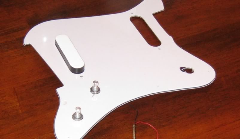

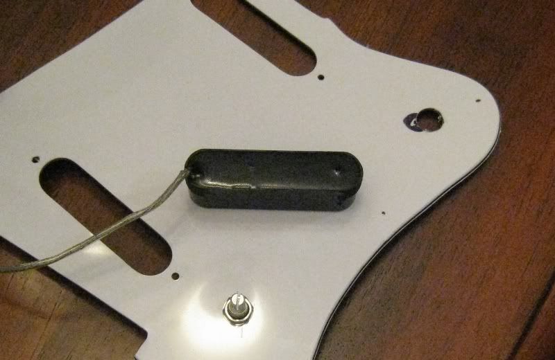

Trimmed the tabs off the Carvin H60s for mounting to the baseplates:
Here is one of the pickups with its first coat of white paint set in the pickguard:

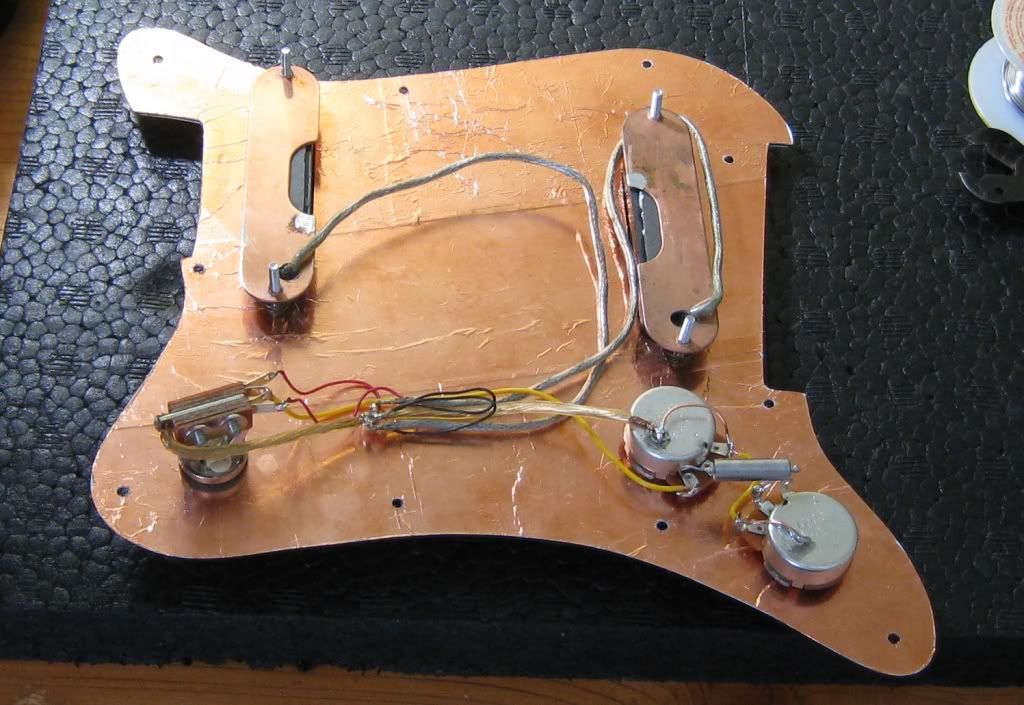

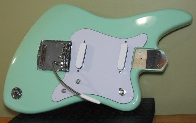

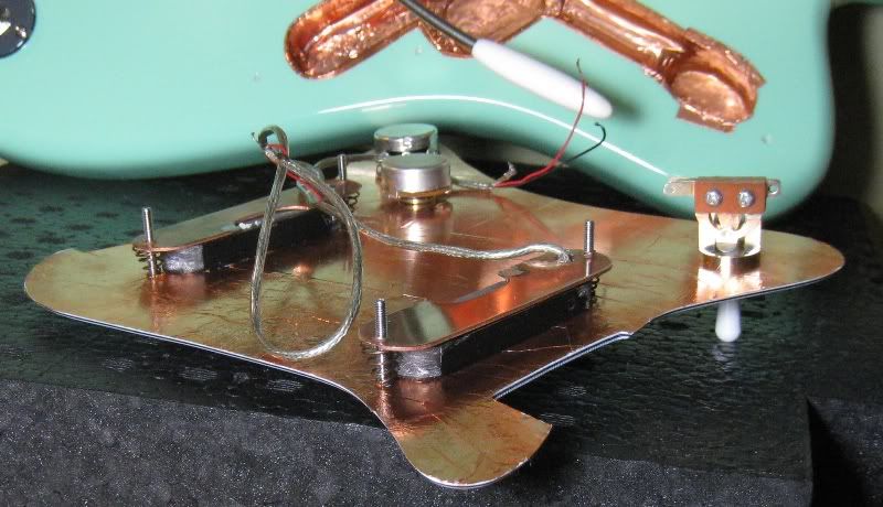

Pickups painted and mounted to the backing plates; pickguard assembled. Of course, I'll have to pull it apart again in order to drill the mounting screw holes but for now...
Don't sweat the alignment...the bridge isn't screwed in so it is sagging just a tad in the pic above.
here's a better shot of the H60s, tabs ground off and mounted to the copper plates.
Next update will be when the wiring is completed.

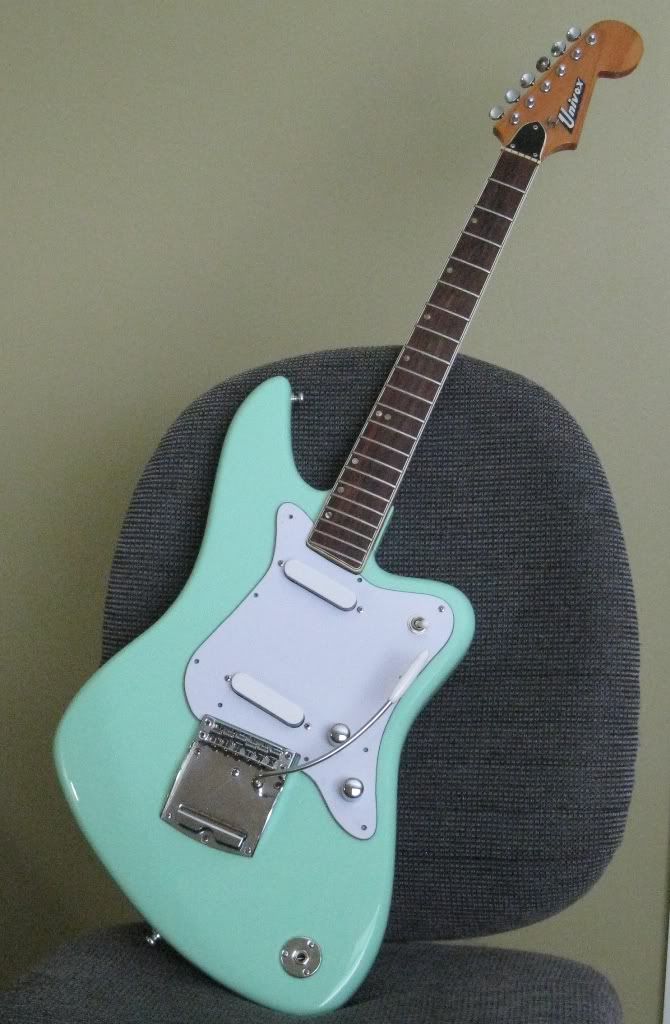

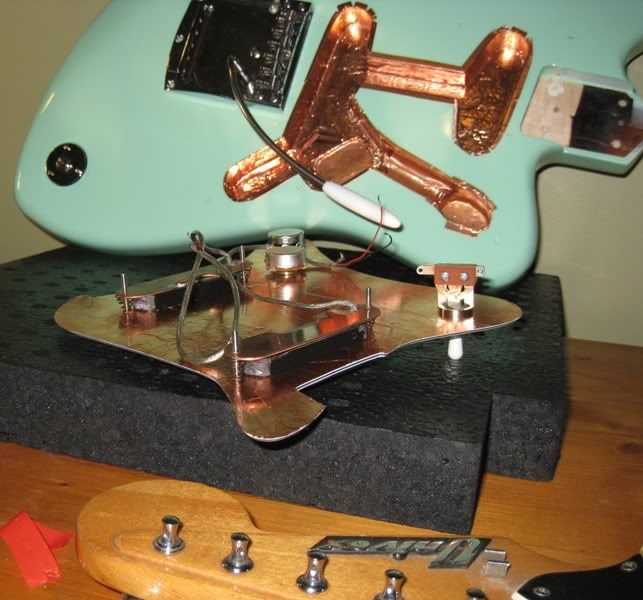

Post by vr6pilot » Wed Aug 17, 2011 3:07 pm
So, this week's lesson is this: drill the mounting holes first.
The pickguard that came off the guitar wasn't even right so using that as a template would have been a fail. Combine that with the fact that my pickguard had some minor shape changes and the difficulty of transferring the hole pattern in the body to a medium and then to the plastic...it didn't work and I am not satisfied with it 'as-is'. What I should have done was had the original holes filled, then I could have run the drill right thru the new PG and had a perfect match up.

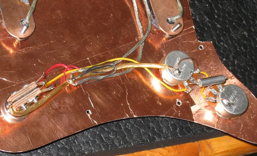

All wiring was completed but the project goes on hold for now while I wrap up some important biz to include prepping for retirement (and ordering another piece of plastic). I screwed the neck and bridge down with the PG...everything but the strings...and shot some pictures.
Here's the wiring:
and how it might've looked ...
This will resume. Stay tuned....
