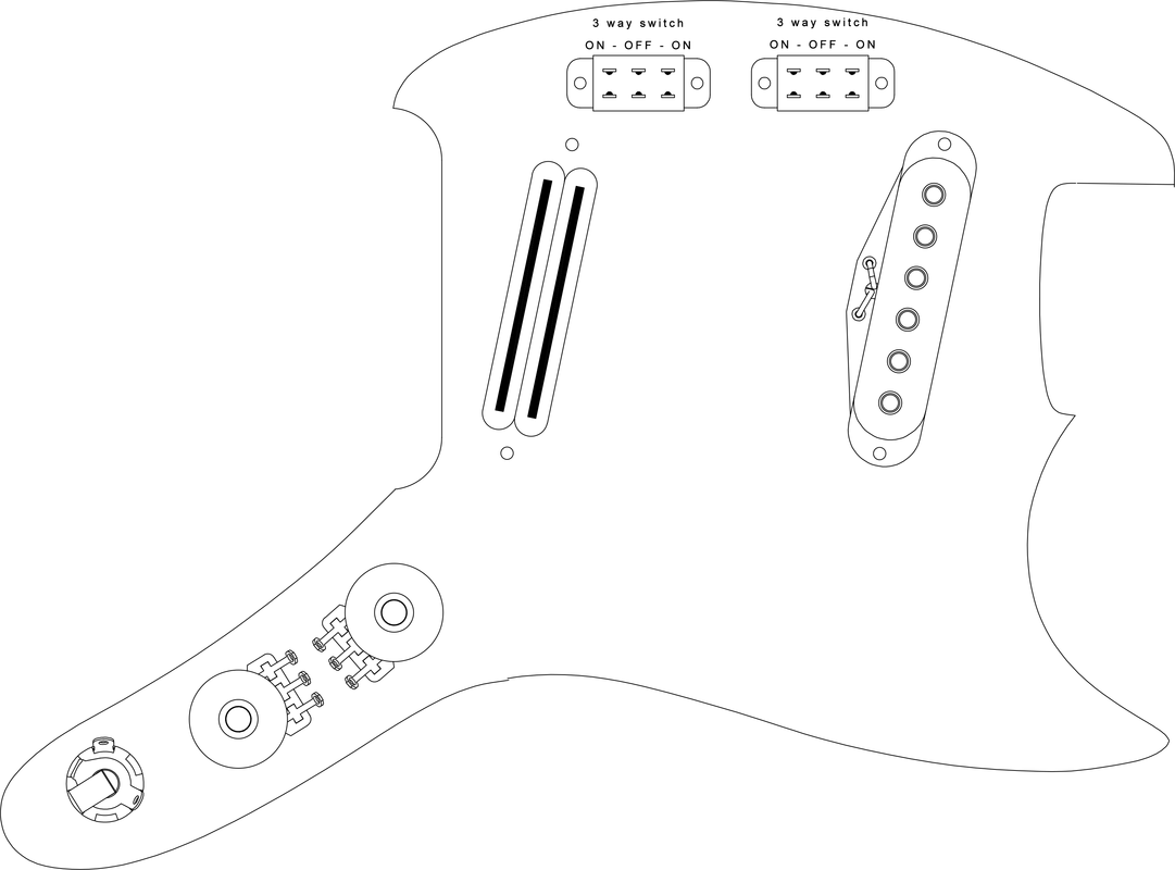

Shadow, Is it possible with 2 3-Way ON-OFF-ON switches (6 pins) to get: Neck/Both/Bridge and a coil split for the mini hb?
if it's not possible what would you do given this configuration?
Futuron
Posts: 421
Location: Australia
Re: Shadoweclipse13's Master Schematic Page!
Post by Futuron » Sun May 26, 2019 3:12 am
If I can be allowed to butt in, I think it's possible as below, assuming by "both" that you mean in parallel, not series.
Neck switch goes on, off, reverse (as per mustang usual).
Bridge switch goes hh, off, coil split.
Colours for humbucker wires are Seymour Duncan, everything else I just made up to differentiate, in case you were wondering.
