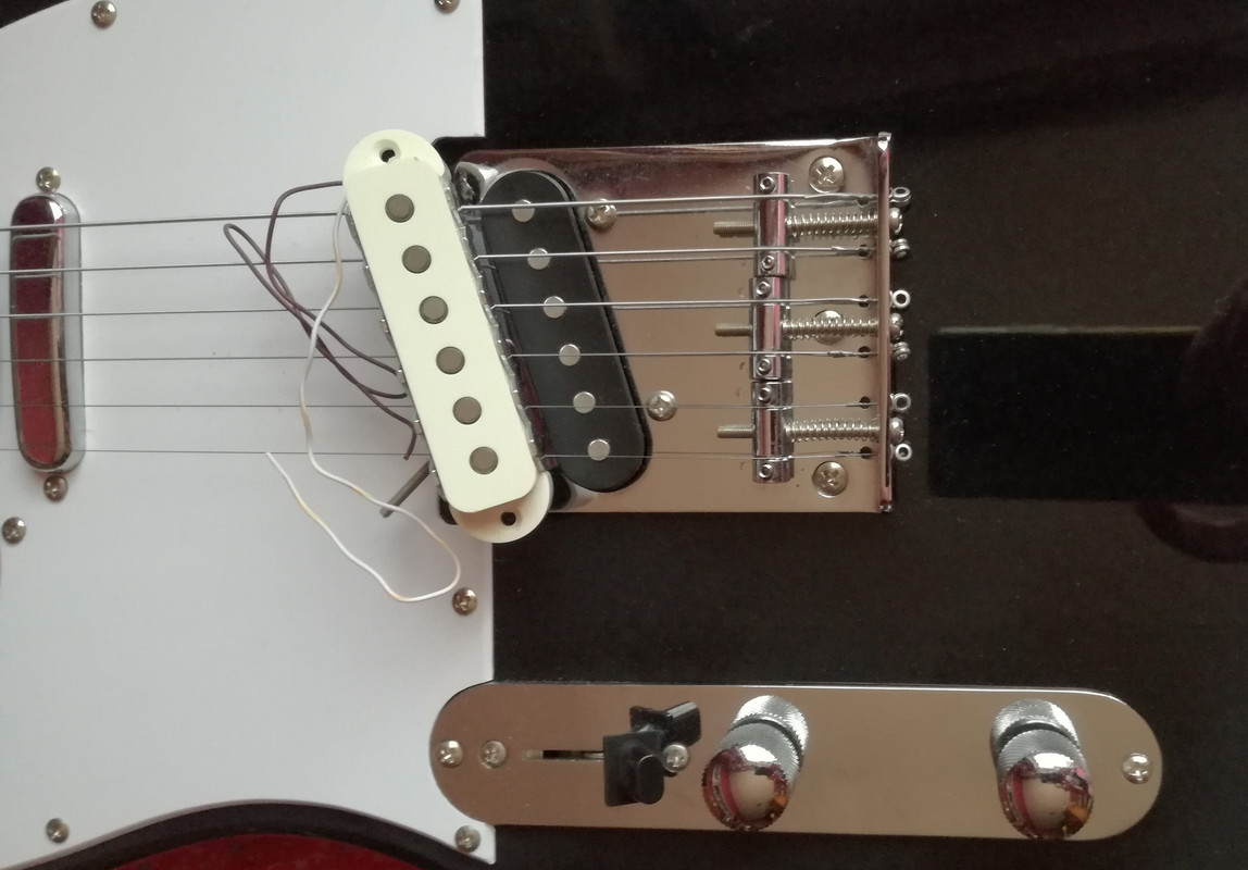

Anyway, luckily I have a Jaguar bridge pickup and a tele to help you out...:
It surely is too big to be covered by the bridge plate...

Hmm.. 🤔 I guess a route , custom pickguard and a new bridge?
