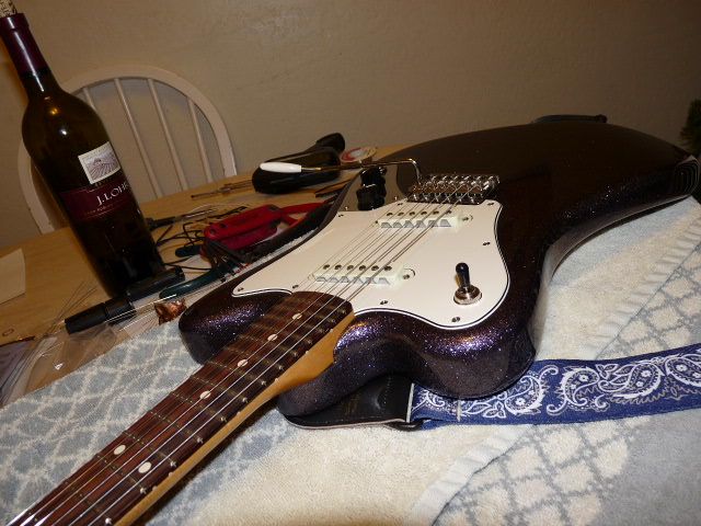

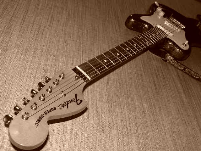

After awhile, I was really hating on the tone. I changed the configuration from two volumes to a volume & tone to get some control over the treble. As simple as this sounds, I had to do extensive re-wiring, and then even with tone control, I just wasn’t digging these PU’s. Discouraged, I ripped everything out of it and left it for dead.
It sat gathering dust with no electronics in it for a few months until forum brother RIORIO and I got talking about our Super-Sonics. Our mutual dissatisfaction with the factory PU’s and controls fueled discussions about modding them which inspired me to resurrect mine (plus, it was something to do).
One naive idea was to install Filtertrons. Fortunately, before I could jump off the deep-end with this, RIORIO found a vid of a guy who had done just that, and forwarded it. After watching it, I abandoned the Filter-tron idea completely. They are nice PU’s, but didn't sound quite right to me inside a Super-Sonic. (thx again J).

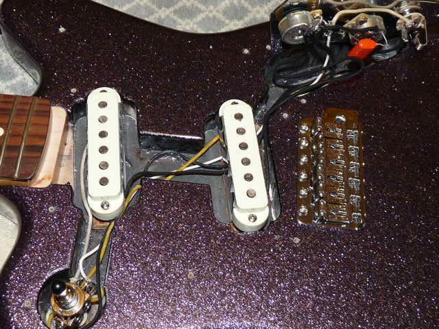

In the meantime, I assembled a parts JM utilizing AV65 PU’s which I was very pleased with, even amazed. Because of this, I decided to go AV65 Jag PU’s for the Super-Sonic and compliment them with some 250k CTS pots, an orange drop cap and vintage-spec wiring. SneakyT cut the new pick-guard for me and did an excellent job.

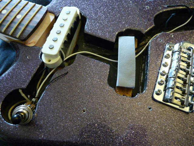

Had to cut a couple of quarter inch thick wood shims to fit inside the factory PU routes so the Jag PU’s would be fully height adjustable for set-up. Fortuitously, these routes were just wide enough to accept the Jag PU’s with less than a 16th of an inch to spare on both sides. I wired it as-per a “deleted rhythm circuit JM diagram” from and old OSG post.

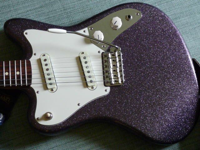

When I plugged it in for the first time, it came to life with a novelty of tone that was totally unlike it was before. The AV65 genes mixed with the Super-Sonic bedrock give this a very pleasing ‘Jaguar-esque” sound. Warm in the neck and neck/bridge and capable of traditional trashy Jag bridge tone. It’s different and familiar all at the same time.
Conclusion: Worth the cost of parts and an afternoon of soldering it together.
