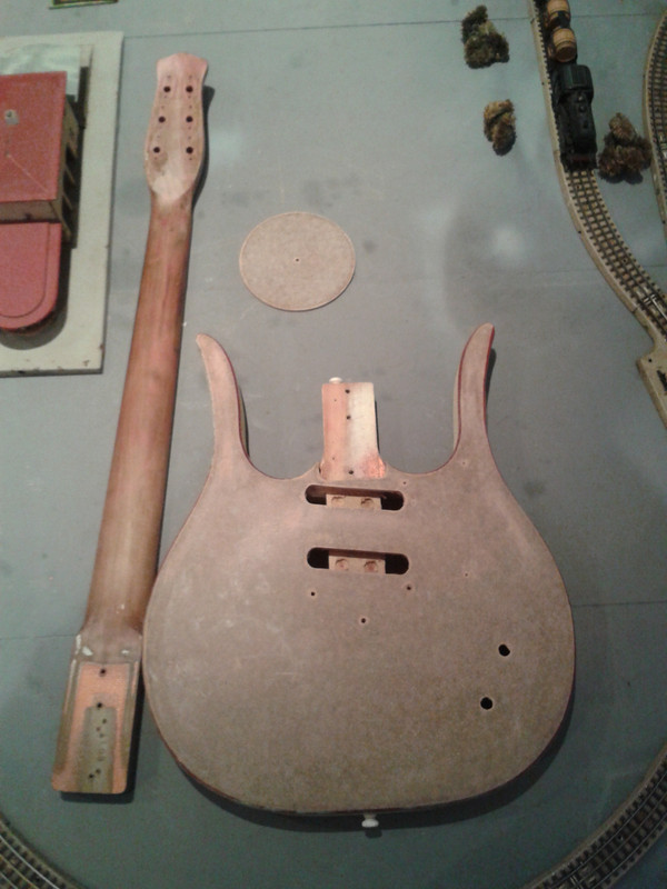

So I've mentioned on here a couple of times before about how I have a 1950s Danelectro with a really shitty refin. I'm planning on finding someone to redo it in its original finish (I'll probably ask Rexter if he could do it as his work looks excellent) but I'd like to strip the finish myself to keep the cost down. I was just wondering if anyone on here has had any experience with refinishing one of these, and if so how did you strip it? I'm assuming that chemical strippers would eat the masonite, and that sanding it would leave it feeling "fuzzy", no matter how fine a sandpaper I used. Any input here would be greatly appreciated. Thanks!

Sanding is likely your best bet, it should smooth up with the fine grits, If not a coat of finish followed by sanding will work.
If the finish on there is compatible l, I would just over spray it.

And yeah- no strippers, delicate sanding back,with a cork sanding block, and nice fine wet n dry paper. If there's a chance the og finish is under there, start with 1000, if there's deffo none, maybe, 400, or 320, but on something marvellous like this it can't hurt to be careful imo.

Yep, it's the Longhorn. I did try finely sanding it in a few areas but there's not enough original finish under there to be salvageable. Looks like it was heavily sanded down to prep it for the refin, the copper is almost completely gone and the cream is through to the primer in some places. It's a shame but still, I'm sooo looking forward to it not looking like crap anymore!

Sorry for the shit photo but strippage has been achieved! Also yes, I have a train set because I'm a massive nerd.
And here's a before shot, just for the hell of it:
After rigorous testing it turns out that Ronsons Strypit is totally fine to use on Masonite, but I still didn't use it on the body because I didn't want it eating the binding tape. I've emailed Rexter and he seems happy to do the refin (and quoted me a great price on the condition that I strip the finish myself). I'll have to send him another email letting him know that it's done. I've also ordered a new headstock decal from some guy in America but annoyingly it looks like it's got lost in the fucking post. There are a few other issues that need sorting out, such as stripping the paint off the pickups and hardware (I think the previous owner painted the guitar without disassembling it ) and the slightly more worrying problem of the potentiometers not working properly and replacements being completely unobtainable. I'll keep posting updates if anyone's interested.

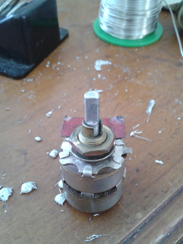

They're CTS 1 meg/100k concentric pots which have unique shafts that only fit Danelectro knobs. Weirdly they both have the exact same problem where one of the lugs isn't connected to the carbon track, and it's the same lug on each pot. The guitar had obviously been poorly rewired by some dipshit at some point so I bet they overheated the lugs or something. Unobtainable might be a bit of an exaggeration as modern reproductions are still available from Danelectro, but they're so cheap and nasty that I'd really rather not use them. I've figured out that I can actually sidestep the issue by rewiring the guitar so that the tone pots work backwards (ie anticlockwise=full treble), but I might carefully disassemble them and fix them with a bit of conductive paint.

If they're both concentric, and both use the same 2 values, why don't you look for a 1meg concentric (1 meg top and bottom) and a 100K concentric (100K top and bottom)? That would surely be easier to find, and if you go to somewhere like Mouser, you might find the shaft shape you need.Squirrel wrote: ↑Tue Oct 23, 2018 11:00 amThey're CTS 1 meg/100k concentric pots which have unique shafts that only fit Danelectro knobs. Weirdly they both have the exact same problem where one of the lugs isn't connected to the carbon track, and it's the same lug on each pot. The guitar had obviously been poorly rewired by some dipshit at some point so I bet they overheated the lugs or something. Unobtainable might be a bit of an exaggeration as modern reproductions are still available from Danelectro, but they're so cheap and nasty that I'd really rather not use them. I've figured out that I can actually sidestep the issue by rewiring the guitar so that the tone pots work backwards (ie anticlockwise=full treble), but I might carefully disassemble them and fix them with a bit of conductive paint.

Yeah, I've considered using different values but unfortunately I just can't find any decent quality concentric pots with the right shafts anywhere. I could concievably buy some CTS pots with the regular shafts and mill them to fit, but I'd have to make some kind of jig to hold them steady and it would be a huge pain in the ass. I'll probably just repair what I have.

Have a picture of the shaft? ... ( ) ... I'm on Mouser all the time and have seen some really funky ones. My thought is, there's no way Danelectro had special pots made JUST for their stuff, you know? It's possible what they used isn't made anymore, but I imagine that it was a more common part at one point, and if another industry uses it, then there has to be something comparable to replace it with.

Warning: this post contains an extremely graphic picture of a shaft.
I'm assuming they must have also been used on old radios and stuff in the 1950s-60s but Danelectro were the only guitar company to use them to my knowledge.

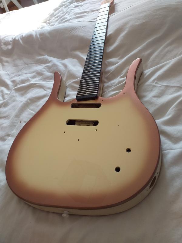

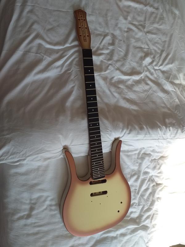

IT'S BACK!
Many thanks to Rexter for doing such a great refin-the thing looks excellent! While the guitar was away I managed to rebuild the original pots, which now work fine, and I also found a more suitable vintage Ace strap for it. I'm not going to be able to reassemble it for a few weeks because of reasons, but will update again once it's done.
