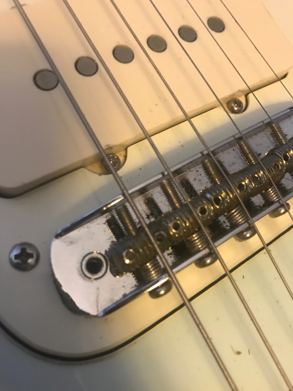

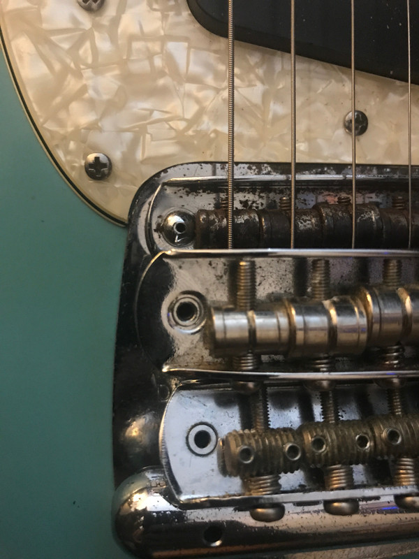

Re: offset bridgepost change: what year?
I don't know dates - But examples of all styles known to me pictured below. I think I'm only really missing AVRI/American Original:
Top to Bottom:
-Early Dome
-Allparts/Squier 'Very Large Hole'
-MIJ 'Flat Large Hole'
Later vintage 'Flat Small Hole' below:
Another example of Allparts/Squier 'Very Large Hole' below in a VM Jazzmaster - Not sure if Allparts & Squier bridges are same supplier and the tooling seems to have slight differences from the above Mustang bridge. They are both pretty sketchy bridges though TBH - Worse than MIJ, and WAY worse than vintage.
Top to Bottom:
-Early Dome

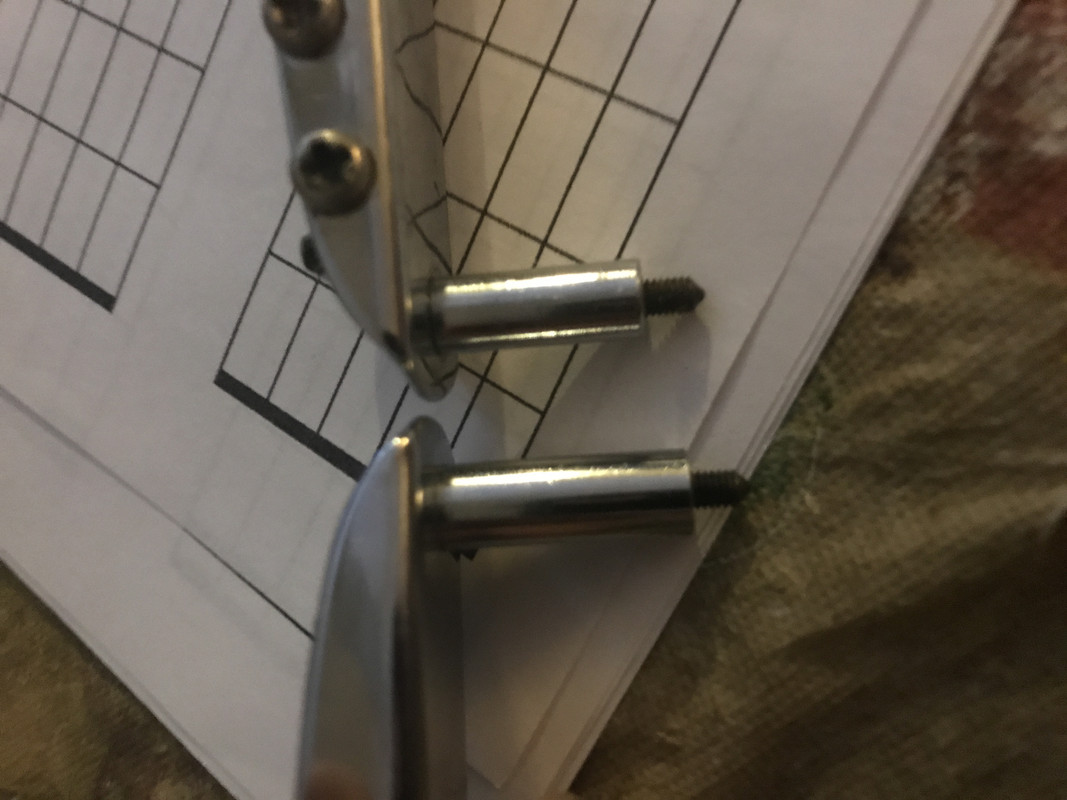

Apologize for dragging this up again- but recognized a difference between an early century CIJ bridge and my MIJ '96 bridge:
CIJ has longer posts.
- timtam
- Posts: 1246
- Joined: Sun Oct 22, 2017 2:42 am
- Location: Melbourne
I suspect we will be discussing the idiosyncracies of offset bridges for many years to come.
So .. longer posts ... and deeper thimbles ? Or not ?
I've noticed a range of things that can subtly affect how much the standard-design bridge (from various sources) can rock. Some can be hard to predict, and their effect may be good or bad depending on your perspective. Obviously how high your bridge is affects rocking - a higher bridge rocks more. Also there is variation in thimble and bridge post diameters - tighter fits on some make them rock less. Whether this is just variation due to manufacturing tolerances or alternatively design variations (eg between metric and US bridges) is unclear. If you drop a new bridge into thimbles that came from a different source you may get a slight diameter mismatch and thus more or less rocking than intended. If your thimble or bridge post locations are fractionally off (closer or further apart), then the posts may 'roll' on the side walls of the thimbles in a more restricted way, rather than rock freely back and forth in the centre of the thimble (without touching the side walls).
I believe that the Marr and Staytrem bridges also have bigger post height grub screws. But I assume the Staytrem has 'standard' diameter posts, as thimbles are not supplied and they are described as drop in replacements.
