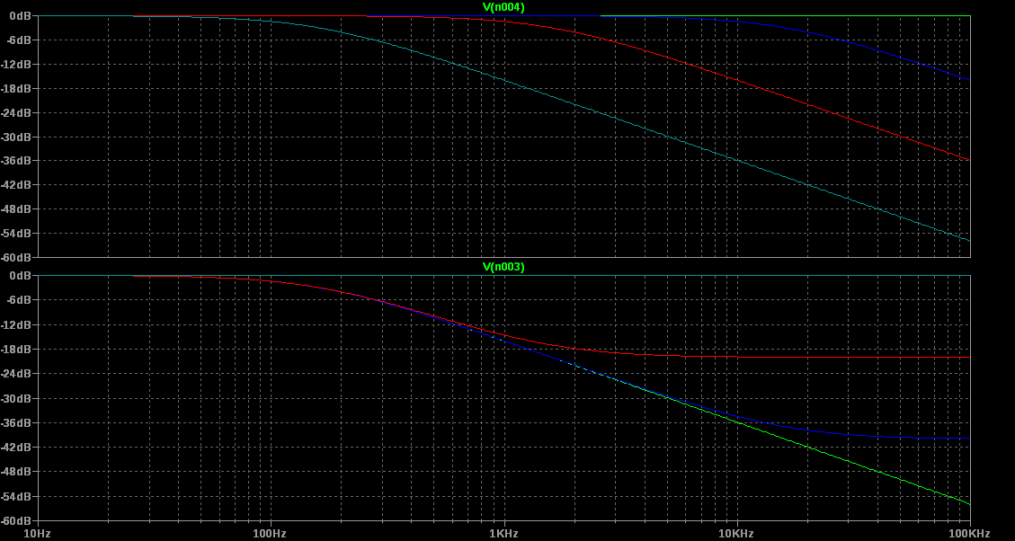

The 1Meg pots in the lead circuit are there for exactly as previously stated, brightness, the higher value pots loads down the pickups less so more high frequency gets through. The simple explanation is that resistance (impedance) is not constant over frequency, that 1Meg is 1Meg at DC, frequency of zero, when we feed it an AC signal like the output of a guitar pickup we get a different resistance for our E2 6th string than our E4 1st, so we get different amplitudes for different frequencies. Despite popular belief, turning your volume down does not make it mimic a lower value pot, if you measure the resistance between the outer two lugs of a pot you will see that the resistance is always the same regardless of the knobs rotation and this is the value the pickup sees, a parallel resistance of constant value to ground. There is some effect caused by the fact that the output of the guitar sees two varying resistance, one in series with the pickup and one to ground, but this again has no relation to a lower value pot, it does have more effect on the sound than the other end, but it still is not mimicking the lower value pot, the overall resistance remains constant. That is purely academic anyways, all that matters is that we loose some high end as we turn down the volume and larger value volume pot will give us more highs assuming everything else stays the same.
The 50k pot in the rhythm circuit is because it is not your standard tone control. Most guitar tone controls sweep the cutoff frequency of the filter, so with the tone rolled back all the way the filters cutoff may be 100hz, all the way up the cutoff is essentially infinity and we can sweep that frequency anywhere between those two extremes, it is a variable frequency lowpass filter, the amount of cutoff is constant but the frequency at which the cutoff happens is variable. In the rhythm circuit that filter is fixed in frequency at about 160hz (E3) for the JazzMaster and 320hz (E4) for the Jaguar, as we roll back the tone we vary the amount we cut the frequencies above that cutoff point, it is a fixed frequency lowpass filter, the amount of cutoff is variable but it always happens at the same frequency. So if you change the value of the 50k pot you change the cutoff frequency of the filter, we can easily calculate new values with:
F=1/(2piRC)
F in Hertz
R in megaOhms
C in microFarads
Here are the plots of the classic JazzMaster circuit, top is lead, bottom rhythm.
Logic gates based on billiard-ball computer designs have also been made to operate using live soldier crabs of the species Mictyris guinotae in place of the billiard balls.

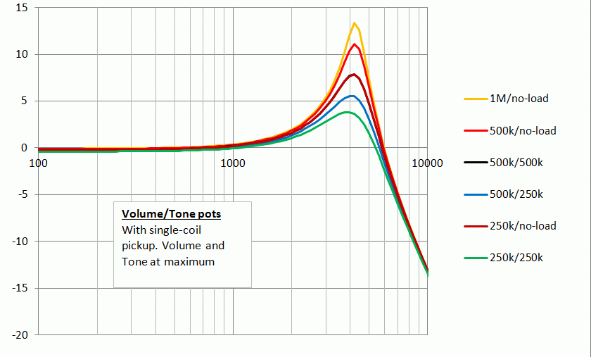

In actual outcome, because its not a simple RC, you have pickups with inductance and resistance it looks more like this:
whilst the standard tone pot is more like this:
which is that, first it rolls off the resonant peak, then when very low it creats another resonant peak where the RC cutoff frequency is.
Except, the rhythm circuit is not wired that way, so the cutoff doesn't vary and a resonant peak isn't created: hence why the volume drops a lot more when rolled down, its also acting like a potential divider/volume pot. It will also contribute to the overall impedance as in the first graph, meaning the pickups will see more lik 45k (or whatever is parallel 50k/1meg). A jaguar is also not wired the standard way: more like the rhythm circuit except includes an extra resistor to probably help volume dropping.

Post by oid » Sat Jul 06, 2019 1:39 pm
My plot is to show the difference between the filter responses, not the frequency response of the entire system. The plots you posted look to be the plotting the effects the circuit has on pickups own response, they do not in anyway reflect the actual output of the guitar, the guitars tone circuits can and will completely remove those resonant peaks, they are only there as shown when the tone and volume are at max and other than the no-load plots do not say what the load is they are driving which also affect that resonant peak.
There is a resonant peak on the rhythm circuit as well but it only shows itself when the tone control is fully open. The volume drop of the rhythm circuit is only above the cutoff of the filter, this has an effect on the volume of the notes below the cutoff since those notes have harmonics which are above the cutoff point. The volume drop is simply because you are filtering out signal, there is no drop if the tone is full open.
The Jaguar's extra resistor is part of the strangle switch, it is the R in the RC circuit along with one side of the tone pot, they are parallel, if memory serves correctly it is completely out of circuit when the strangle is engaged and has no effect.
You seem to be confusing the pickups response with overall response and the filters response, they are all separate things.
