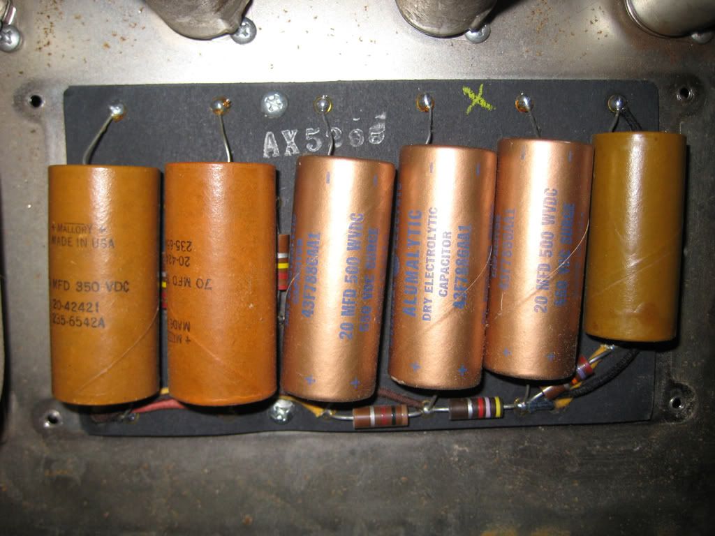

The crackling could be a loose tube but it could also be a cold solder joint. Some "chopsticking" might be find the culprit fairly easily but if I were to start somewhere I'd start where the caps have been swapped out. Great score!
- Pacafeliz
- Posts: 19182
Re: Checking out a BF bassman - now w/ photos!
yep, it's a early '66 according to the late '65 components.blacktiger wrote: Looks like the caps under the doghouse have already been changed (good). The board looks to be more or less original (also good). Nice score.
I'm thinking that you have an early '66 there (as indicated by late '65 parts). What's the two letter code stamped on the tube chart?
CAUTION: the caps under the doghouse ARE the originals and -even though they look ok- NEED to be changed ASAP, specially if there's one spilling out the guts. you just have to do that every 25 years or so, but it's better to be safe than sorry. a good tech can re-cap it in 30 mins, or you can do it yourself. you'd need the caps (i buy em at www.tubesandmore.com) and be CAREFUL. those babies store the electricity and can KILL
is there background noise/hiss/crackling? if yes that's the definitive indicator that it needs a recap. no biggie, but better safe than sorry. it's the 1st thing i do when i get a "new" old amp. and while you're at it, change the bias cap too. your tech will know. it shouldn't be more than 80-100 bucks and you can enjor yer amp for another quarter century with no fear heh.
it looks great and original (heh seen the green diamond?!), nice and clean.

Those three gold ones don't look orignal, but the other three could be. They're not obviously bad from the pictures (I can't see any bubbling), but Pat's right, you should have them checked out to make sure that they're okay.Pacafeliz wrote:CAUTION: the caps under the doghouse ARE the originals and -even though they look ok- NEED to be changed ASAP, specially if there's one spilling out the guts.

Yes please....replace the big electrolyte caps under the doghouse asap! they are indeed dangerous....
Find a good tech and have them replaced.
Look what you got in the pre amp section (V1 and V2)
Perhaps they need to be replaced.
Should you be looking at new power tubes, then I strongly suggest JJ 6L6. Very nice tubes with lots of headroom. My tech swears with them and they are not expesive as well.
I wonder what speakers you got there?

heh... not to stir up a fuzz but i guarantee those golden ones are the originals, as well.blacktiger wrote:Those three gold ones don't look orignal, but the other three could be. They're not obviously bad from the pictures (I can't see any bubbling), but Pat's right, you should have them checked out to make sure that they're okay.Pacafeliz wrote:CAUTION: the caps under the doghouse ARE the originals and -even though they look ok- NEED to be changed ASAP, specially if there's one spilling out the guts.
post the numbers on those, i bet they are '65
- blacktiger
- Posts: 4142
- Joined: Sun Nov 12, 2006 7:05 pm
- Location: banned in DC
I'll defer to you on this one, since I'm used to slightly earlier Fenders. Why the mismatch with the two different types?Pacafeliz wrote:heh... not to stir up a fuzz but i guarantee those golden ones are the originals, as well.
post the numbers on those, i bet they are '65![]()

dunno... maybe supplier problems. or... since CBS was trying to get cheaper stuff. i've seen this in several fenders of the era, which i've recapped.blacktiger wrote:I'll defer to you on this one, since I'm used to slightly earlier Fenders. Why the mismatch with the two different types?Pacafeliz wrote:heh... not to stir up a fuzz but i guarantee those golden ones are the originals, as well.
let's see a close-up pic of those caps to read the manufacture date... or... let's take this outside!!!

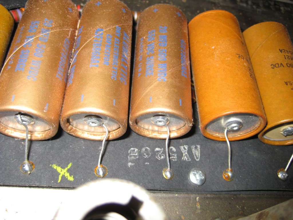

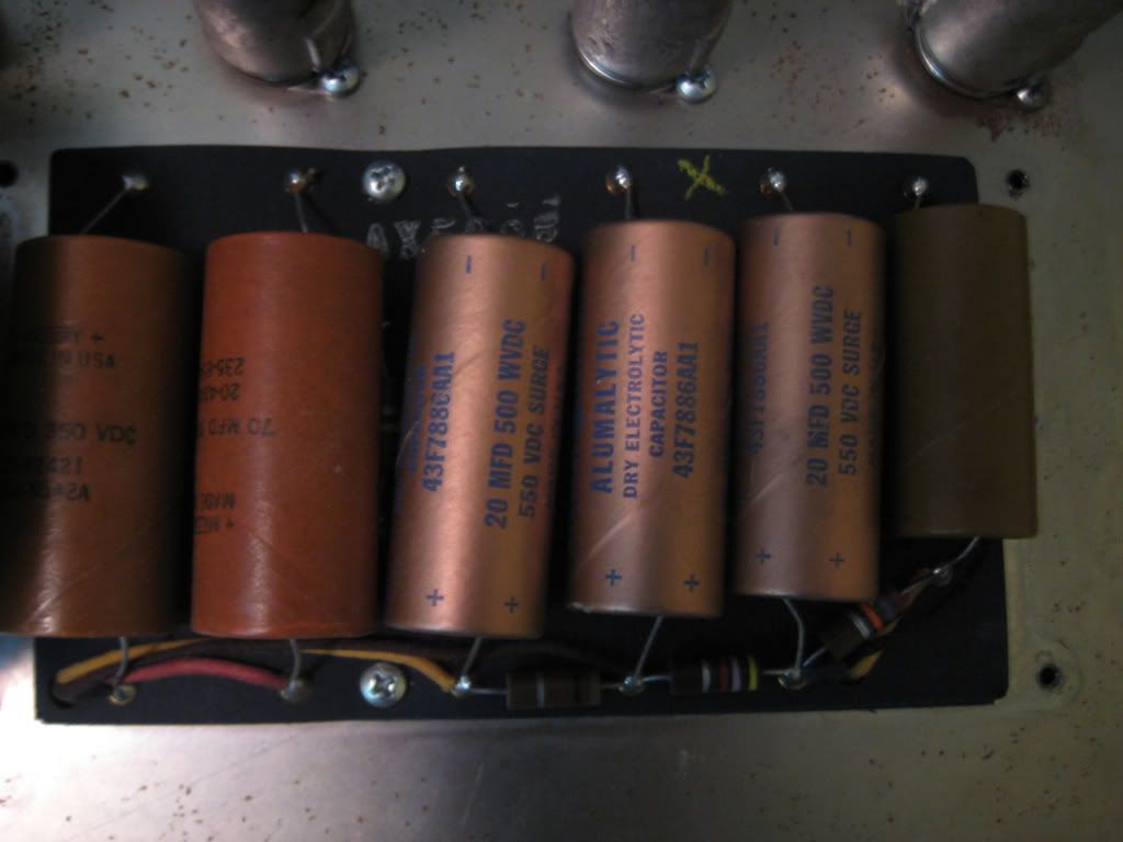

don't have the amp at home right now, but here's some larger ones. if it'll avoid a royal rumble, i can take some more shots this weekend if these don't shed some light on the issue. somebody let me know if giant photos aren't kosher on the board...Pacafeliz wrote:dunno... maybe supplier problems. or... since CBS was trying to get cheaper stuff. i've seen this in several fenders of the era, which i've recapped.blacktiger wrote:I'll defer to you on this one, since I'm used to slightly earlier Fenders. Why the mismatch with the two different types?Pacafeliz wrote:heh... not to stir up a fuzz but i guarantee those golden ones are the originals, as well.
let's see a close-up pic of those caps to read the manufacture date... or... let's take this outside!!!i'll see you behind the cafeteria at 12. *crunch crunch*
- Jay
- Admin
- Posts: 7779
- Joined: Mon Sep 11, 2006 5:01 pm
- Location: Santa Ana, CA
Giant photos are cool though it's usually nice to link to them instead of embedding them so that the page loads a bit quicker for some. Those solder joints are certainly untouched. I'd replace them and save the originals.
- Pacafeliz
- Posts: 19182
yep they ARE the origs!Jay wrote: Giant photos are cool though it's usually nice to link to them instead of embedding them so that the page loads a bit quicker for some. Those solder joints are certainly untouched. I'd replace them and save the originals.
apparently there's no bubbling visible, but for safety's sake i'd still (get it) recapped.
btw, there's no use of keeping the originals. it's not modding, it's just maintainence that WILL have to be done, sooner than later. or it might blow up the amp.
plus, again -better safe than sorry- remember these thingies can be dangerous and KILL if you don't discharge them correctly!

This is the inside of my all original 1965 Bandmaster:
Same caps.... did replace them though
