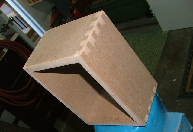

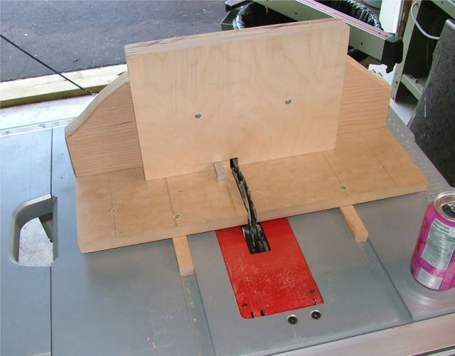

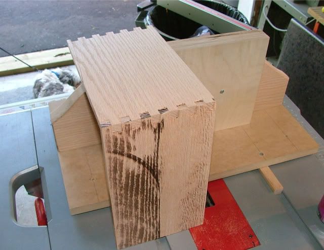

Got my jig-on today:
Scrap panel test joint:
Turned out alright. The scrap panel wasn't squared and the blades should have been raised a hair higher, and so the depth is a little off. But it's a nice tight fit that needed a few swift bops with the mallet to join together. It doesn't flip out or budge when picked up, either. I'm also going to find/make a filing device to clear out slivers or rough edges - i want the joints on my cab to be clean and snug!

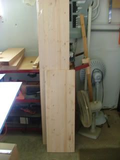

Post by Stratelejazzuar » Thu May 20, 2010 8:11 am
picked up a couple lengths of 3/4" laminate pine planks from home depot yesterday. no pics, sorry - camera batteries died. >:(
didn't think i'd be able to cut for the cab so soon, so i didn't have my measurements worked out :squint:. i figure i'll keep the bassman head dimensions the same, but sort of 'stretch' the bottom down to accommodate the 15" speaker.
it's looking like my dimensions will be about 9.5" x 22" x 25"

batteries charged, here's the pine:
and here's an MDF box test i did 2 days ago to make sure we didn't just get lucky on the first rough joint
hopefully i'll get the pine ripped to width and cut to length this afternoon. :)

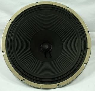

Post by Stratelejazzuar » Fri May 21, 2010 9:41 am
and this just in! i clicked "submit" on my last post real quick to answer my cel phone - "canada post.i have a parcel for you..."
speaker is in! but lol, i'm not at home :squint: BUT, they're going to leave it in the landlord's office, and i can just go pick it up later on this evening :)

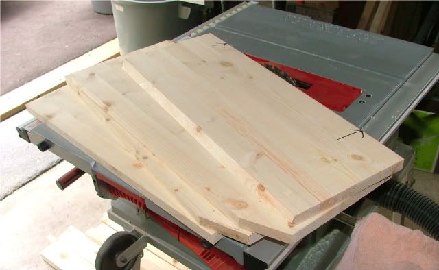

Post by Stratelejazzuar » Fri May 21, 2010 5:21 pm

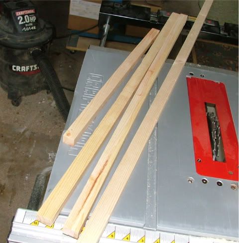

Narrowed the boards for cab depth. Cut two sides for cab height. Cut top and bottom for cab width.
Cab dimensions = 22" x 24.5" x 9.5"
Cut and angled the top shorter for control plate access, and then cut the side tops to match.
"What a pile of cab!"
the remaining 2"+ strips were cut to 1" and will be used for the baffle and back panel strapping.
then i set up the joint jig rig, called it an afternoon, and enjoyed a nice cold beer! :)

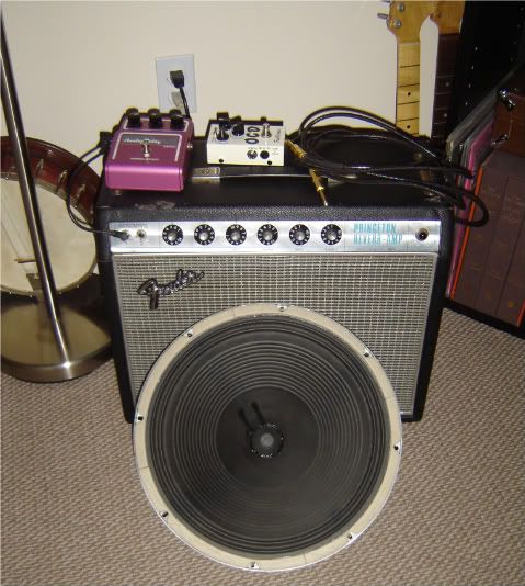

after supper consisted of opening a box o' 15" speaker. maybe i should get another to put in my princeton reverb? ???
;D
secndshft
Re: Bassman 1x15 combo: Box Wood Cut to Length
Post by secndshft » Fri May 21, 2010 7:04 pm
^^^^HELL YEAH! DO IT. I have wondered what a princeton w/15" would look/sound like. I love the idea :w00t: :w00t: :w00t: :w00t:
