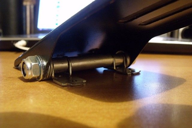

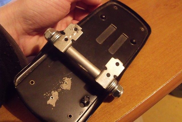

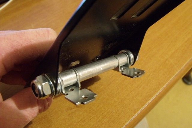

Some progress on the spindle of the foot paddle:
I've used parts of hinges to make the spindle support, it now stands lower than with the first idea, that's better. The way I have made it gives the foot paddle a pretty tight movement, which I like. I've stripped the enclosure (except the foot paddle), the next step is to apply aluminium sheets behind the many holes I want to cover and fill these holes with the Sintofer to have a flat surface.

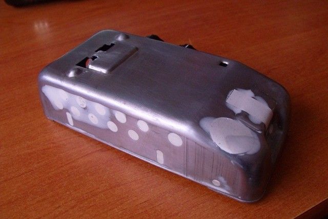

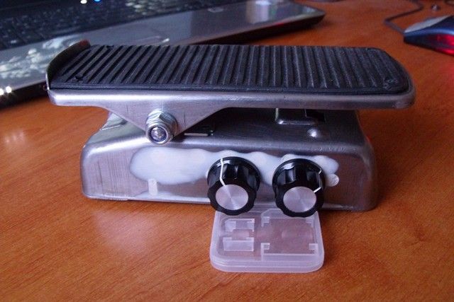

Today I've applied the Sintofer to fill in a part of the holes, this thing seems to be hard as metal when dry. I can't wait to sand it tomorrow to see if the work is clean, as now it is pretty ugly.

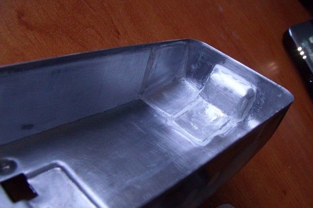

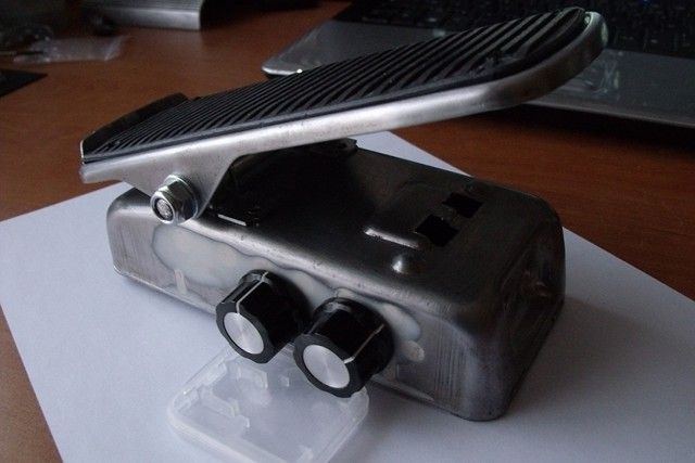

So far the project is going on slowly but surely, I've stripped the enclosure down, and I am filling all these holes that are on the pedal. The process needs to cut a sheet of thin aluminium to size and to stick it behind the hole in the inside of the enclosure with the Sintofer, and to fill in the remaining hole with the Sintofer on the other side. This works very well, and the paste seems to be very very hard when dry. Only a few cracks can appear but I just have to apply another thin layer on top, and the patches are really flush with the rest of the enclosure after a bit of sanding.
The patches behind the holes:
I'll paint the case blue, either a kind of sonic or daphne blue, or if I can find it, a blue hammered paint like the one you can find on a lot of industrial machines.
I also plan to cut a rectangle piece of aluminium sheet to place it in the middle of the rubber part of the foot paddle, to add a nice 'logo' to it.
I've ordered all the stuffs to build the mechanism of the rack and pinion, as well as the tremolo kit that should get home next week
