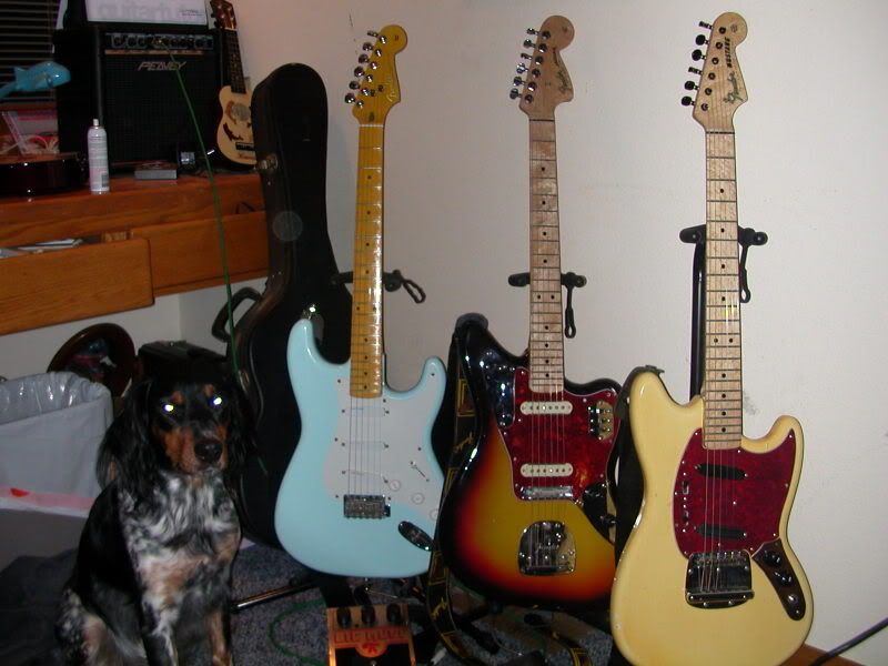

Hi guys.I'm new here, and have a jazzmaster question. I am going to build a jazzmaster body and was wondering if anyone knows exactly haw thick the body is. I know they started making them thinner around 1960, but I cant find the actuall measurement anywhere. well I was told you guys would know.\
Here's som pics of my other guitars
my 66 jag and 65 mustang I rescued from eBay as routed to hell bodies anput warmoth necks on, and an 80s korean squire I refinished and made into a 60s strat replica

kick ass guitars!!!!

She's my gaurd dog
"Dont even look at these guitars or I'll rip you to shreds"
