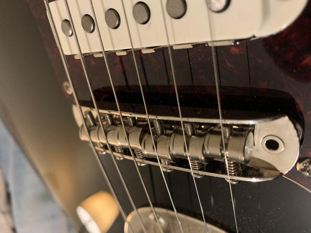

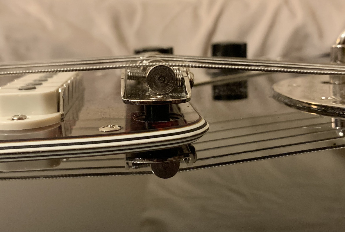

I've attached some photos below. The string definitely isn't hitting the front or back of the bridge plate, there seems to be enough clearance even when fretting. Same with the intonation screw end, there's a good amount of space between that and the string. It's mostly on the G string, but it sometimes occurs on the D and B strings as well.
If it is indeed the spring, then I wonder if applying some loctite to the screw (where it sits below the spring) would help, or might cause some issues. :derp: Image Image Image
