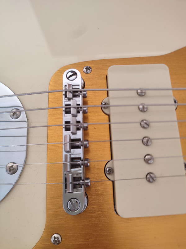

Holy shit, I think you two may be onto something. In images for the guitar the saddle screws face the bridge. The saddle screws are currently facing the pickups on mine. I managed to find an old photo of it from the day I took it for assessment:
Also facing the bridge.
So it may have been reversed during the setup? This could be the issue, right?

They’re adjustable (and presumably the “tech” did adjust these to set the intonation). How’s the intonation at the 12th fret?
I can double-check later, but it was fine by his measurements.
The three problematic strings are as far back as they can go, while the others have some wiggle-room:

Post by sal paradise » Thu Feb 02, 2023 2:08 am
The saddle would still have to be all the way back on those strings even if the bridge faces the other way…
The TOM on my mustang & my LP both have the screws facing the neck.

I still think it's the nut/neck relief too but if you flip it back around the other way and it works, then it works. It just takes a few minutes to loosen the strings and give a whirl even though it probably won't work.
It doesn't matter which was the screws face on the TOM bridge just so long as they face whichever way they were when it was set up and intonated.
