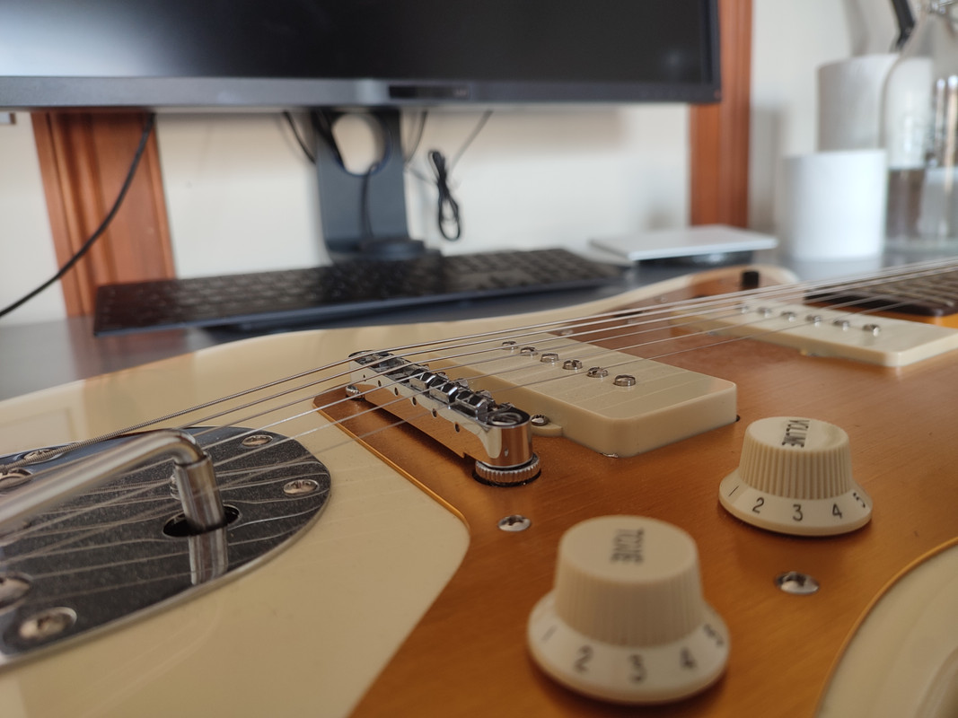

Pictures of the bridge, nut, etc might help.
Shaving down the neck for break angle is wild
don't ever take a guitar back to that crackhead!
My initial thoughts would be that the nut is cut too high or the fret install was bodged

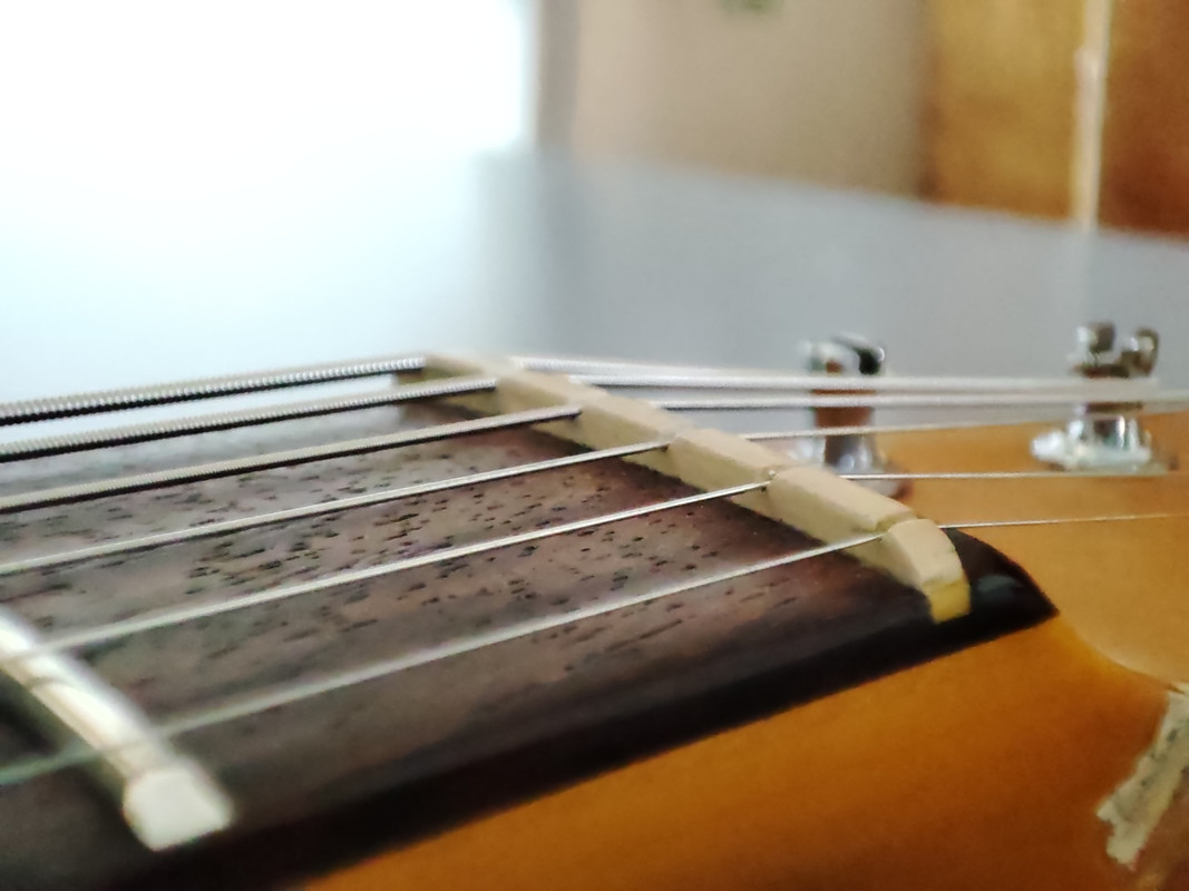

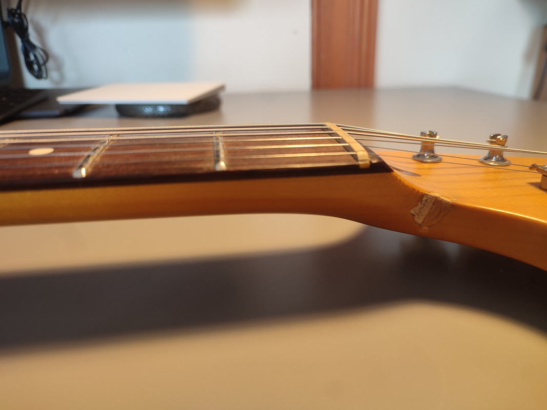

Photos, as requested. Sorry for the quality - the macro lens on my phone is hit or miss, but I can try again if these are no good.
Videos with clearances:
https://imgur.com/a/FOqycWv

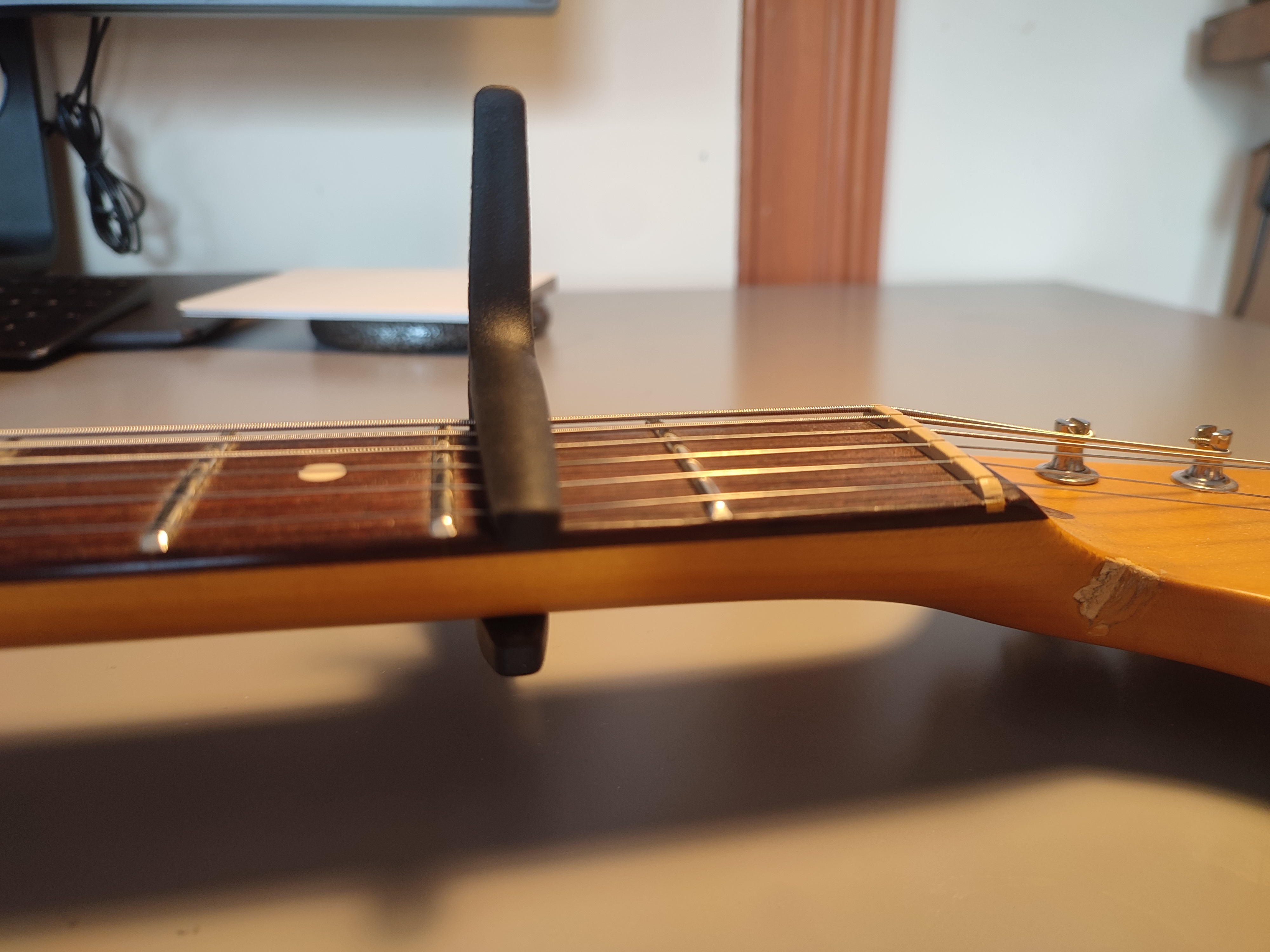

To check the clearance of the first fret you need to capo at 3rd and tap until it touches the fret, not the fretboard. That's your clearance amount.

Whoops. How's this?johnnysomersett wrote: ↑Wed Feb 01, 2023 5:57 amTo check the clearance of the first fret you need to capo at 3rd and tap until it touches the fret, not the fretboard. That's your clearance amount.
https://imgur.com/a/d6ZV4yT

Clearance looks okay with capo at 3rd, could come down a touch but not enough of an issue to cause big problems.
If the reason they're fretting as sharp is hand pressure then bigger strings will improve the issue. Or playing lighter with the left hand.
Your bridge looks to be utterly decked, which isn't right. Probably because the tech 'shaved' the neck instead of just doing what's been done for 60 years on these guitars and just added a shim. What he's done is stupid and non-reversible.

Good videos. To my eyes, that nut looks high (higher than I have mine anyway, but it depends how you play).andyman wrote: ↑Wed Feb 01, 2023 6:26 amWhoops. How's this?johnnysomersett wrote: ↑Wed Feb 01, 2023 5:57 amTo check the clearance of the first fret you need to capo at 3rd and tap until it touches the fret, not the fretboard. That's your clearance amount.
Something else we haven't suggested, I don't think - capo at first fret and tune up. If it now plays in tune, the nut is the problem, one way or another. It's also possible I suppose that the nut is cut so that the string is not sounding off the front edge if the slots are cut poorly, so making the string length longer. It would quite probably buzz at the nut too if that was the case.. Either way, try the capo.
EDIT - agree with Johnny about the bridge. You can still shim it to lift that up, but there was no reason to shave the neck down.
