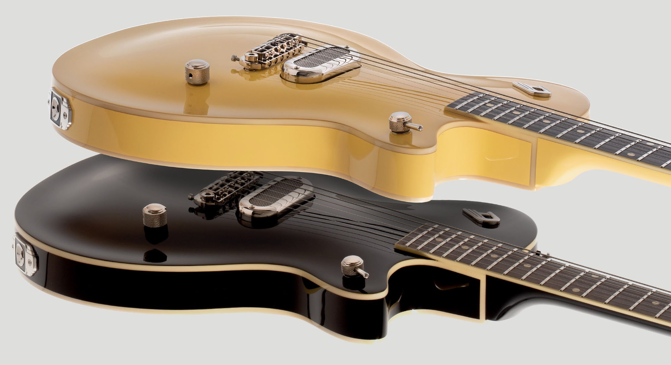

I just stumbled upon this and remembered this old thread.
Looks to be exactly what I was looking for. Don't really need one now, but it's nice to know it exists. :)

is that a badass bridge ?
mynameisjonas
Posts: 12860
Location: Stockholm, Sweden
Re: wraparound tune-o-matic?
Post by mynameisjonas » Wed Sep 11, 2024 4:36 am
It's a Duesenberg. It's featured on their Senior model, although that might be the standard spacing wraparound (they make both).
