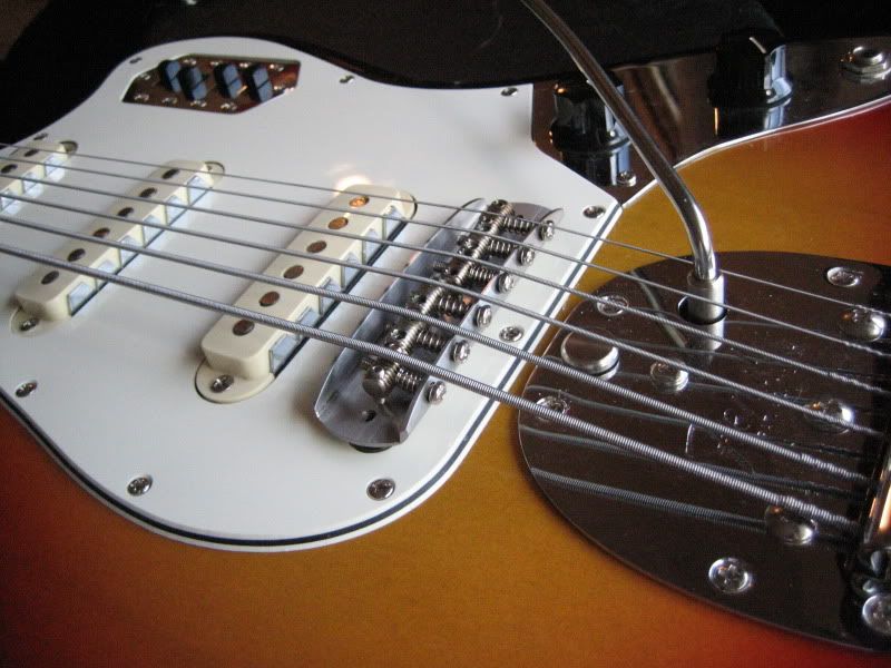

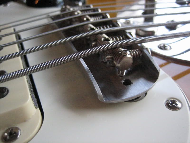

Well, I'm down for one, myself. I'm not sure about specs, but it looks like the 1" wide idea has gone down pretty well. I just emailed Roberto (motel_asimov) to ask about his maker. I'm thinking that the 55mm string spacing would be good for me, as well.
Here's Robertos picture of the bridge he had made in Nicaragua.
