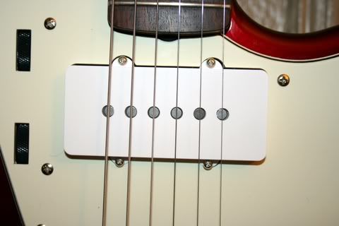

Alright, well maybe it's just my pickguard, or maybe it's just the mint pickguards that are a little bigger cut.  Like I said, I've read of this problem elsewhere.  I don't have a photo of me trying to fit my aged covers on there but you can see how tight the CIJ ones are already in this photo:
They're already basically pressed right up against the pickguard at the screw holes.  You can also see how badly the pole piece holes line up with US-sized pickups.  (The same would be true with the AVRI covers and CIJ pickups.)  I had to file my holes too, *and* I had to file the inside of the cover itself so the pickups would fit in there.  They fit right into the aged covers, though, so my CIJ covers are clearly smaller.
But hopefully stilwel's stuff will all fit together like you guys', and it'll be all's well that ends well.

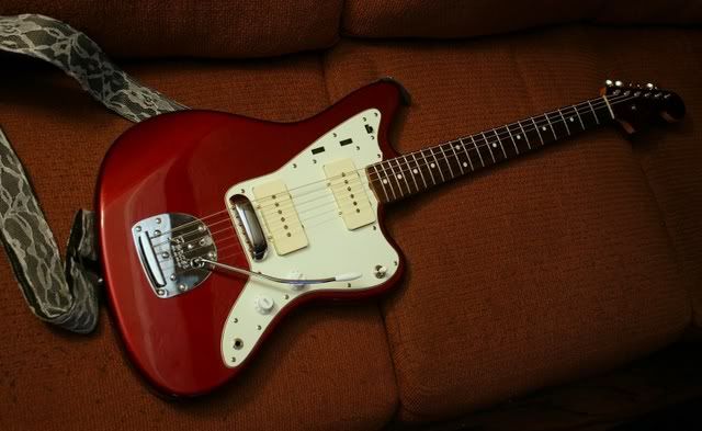

Ok, I'm dredging this topic up again because I finally changed my strings again and I tried the AVRI covers - they fit!  Just *barely*, and I did have to really jam them in there, but they did fit.  And the nice thing is my pole pieces fit the covers properly now.  Though the poles on the SD antiquity II's are really short, so they don't quite sit flush with the cover itself - they're a bit below the top.
I know I'm in the minority but I'm not sure if I'm into the fake vintage-ized look:
I will probably pick up some new knobs and tips and then see how it all works together.
