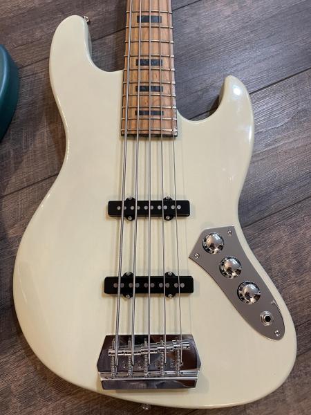

Thank you! It's embossed like a number of other builder's deluxe models, so combined with the roasted maple, it really gives the necks and upgraded vibe.

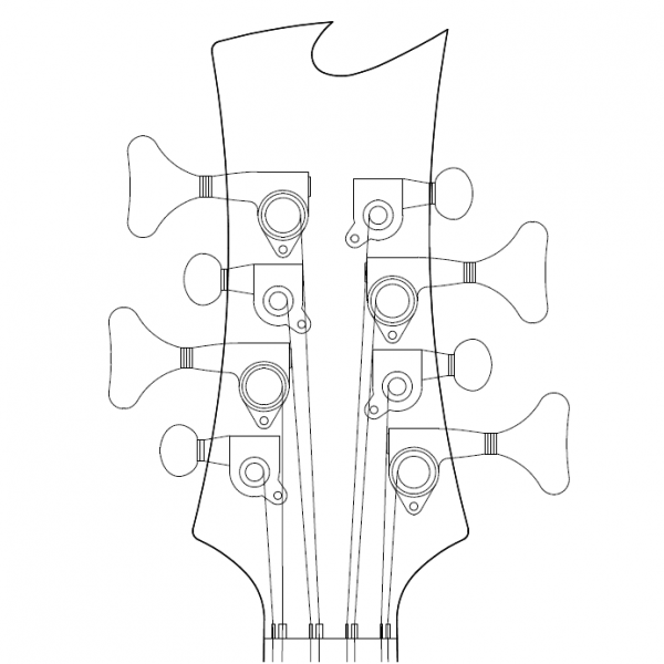

A little teaser: Here's the 4+4 headstock design. The plan is to offer a 32" scale 8-string conversion neck and BRIDGE that will convert an American-spec bass from 34" scale 4-string to 32" scale 8-string. Added bonus: the bridge will retrofit a standard 5-hole bent-plate bridge with no modification.
Is this something you never knew you wanted but now absolutely must have? Let's hope so!

I don’t buy necks very often. Any idea what price range this will fall into?BeeTL wrote: ↑Wed Mar 24, 2021 3:53 pmA little teaser: Here's the 4+4 headstock design. The plan is to offer a 32" scale 8-string conversion neck and BRIDGE that will convert an American-spec bass from 34" scale 4-string to 32" scale 8-string. Added bonus: the bridge will retrofit a standard 5-hole bent-plate bridge with no modification.
- BTL
- Posts: 1768
- Joined: Tue Jul 12, 2011 1:24 pm
Re: Lowe Guitars shop notes
@countertext Ballpark, about $800 for the neck and about $150 for the bridge.
Here's a current listing on a 4-string neck for basic specs and information, but the 8-string will be tiltback and natural maple vs. roasted:
https://reverb.com/item/39445580-lowe-c ... -nut-width

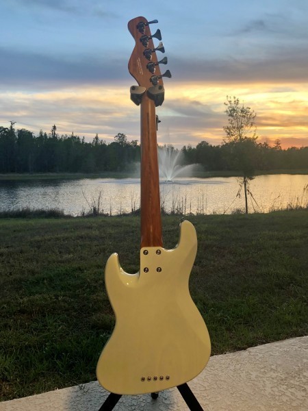

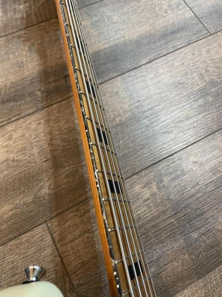

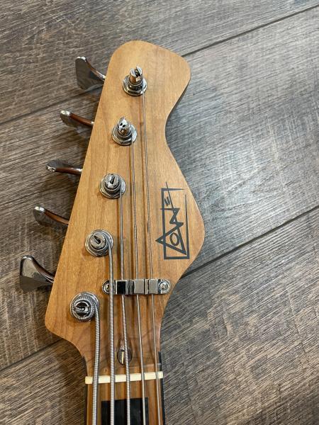

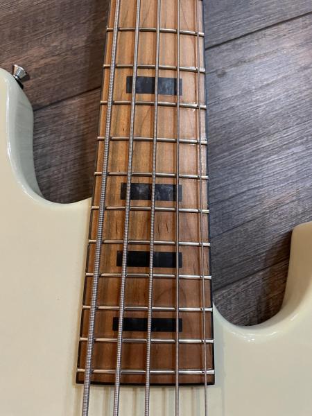

The daylight photos aren't much better, but this one's heading out the door. Getting a consistent photo setup worked out in the new space is next on the to-do list.
This is the Jayluxe V32 5-string conversion neck prototype. The specs are as follows;
• CNC-milled and finished in the USA
• Roasted swamp ash body with glossy TV Yellow urethane finish
• Lindy Fralin Standard Jazz V pickups
• Roasted maple neck with roasted maple fretboard
• Pearloid blocks and binding
• Satin urethane neck finish
• Black Lowe Custom Guitars logo
• Scary Creative silver ink dry transfer serial number
• Shiny chrome bullet headstock truss rod adjustment
• Carbon fiber reinforcement rods
• Tusq nut
• Hipshot Ultralite shiny chrome machines
• Hipshot shiny chrome string retainer
• Carbon steel inserts for 8-32 machine screws

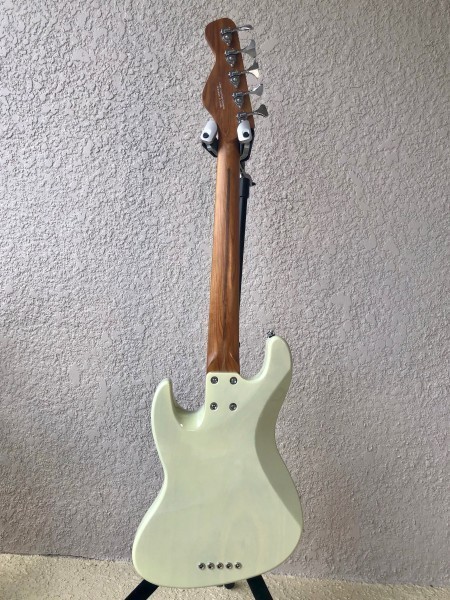

Ryland sent me some better pics of the Jayluxe V-32 along with is Jayluxe IV-32, so I'm posting them here for posterity.

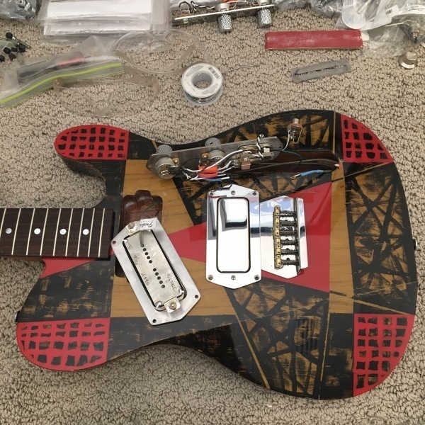

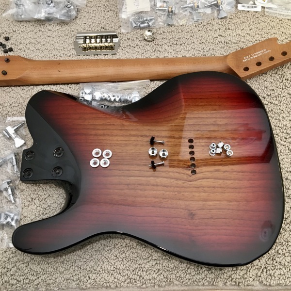

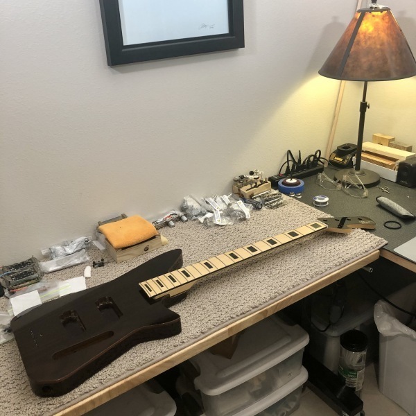

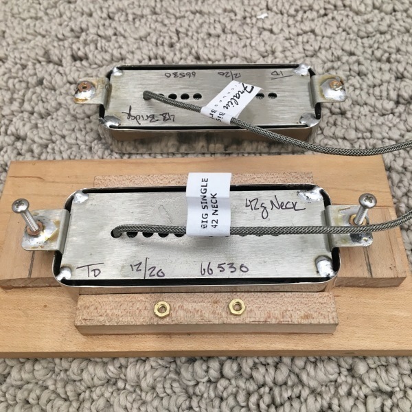

Back in the saddle...buttoning down the details. Ferrules, strap buttons, and tuning machines aren't glamorous, but they don't install themselves. The Fralin Big Singles come to me on a dogear baseplate, so I made a jig to solder on the brass nuts. It's tough to see, but all of the pickup ring mounting holes have beeswax in them to guarantee serviceability. I'm still using hand-wired plug-and-play wiring harnesses with mil-spec D subminiature connectors.
The Paradise guitar is pretty much ready to ship. It has a pretty compelling backstory, so I'll probably start a separate thread on it at some point.

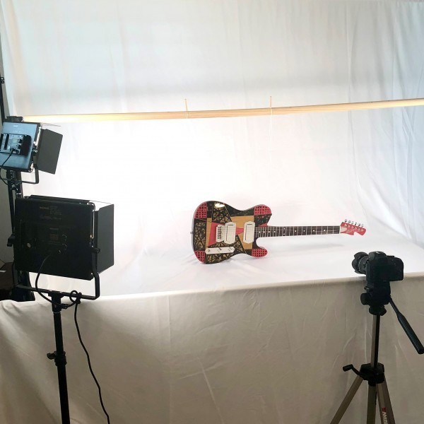

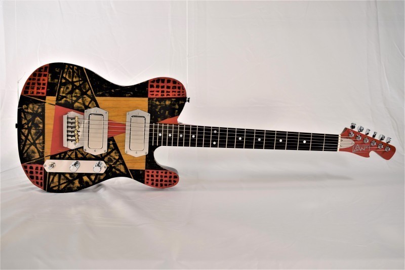

The free Corel Paintshop Pro app I got with my camera seems to have tanked on me, and rather than try to reinstall it, I downloaded GIMP. I did some basic color correction in the MS Photos app, then I followed the workflow detailed in the video below:
https://www.youtube.com/watch?v=L5uVTEItvHo

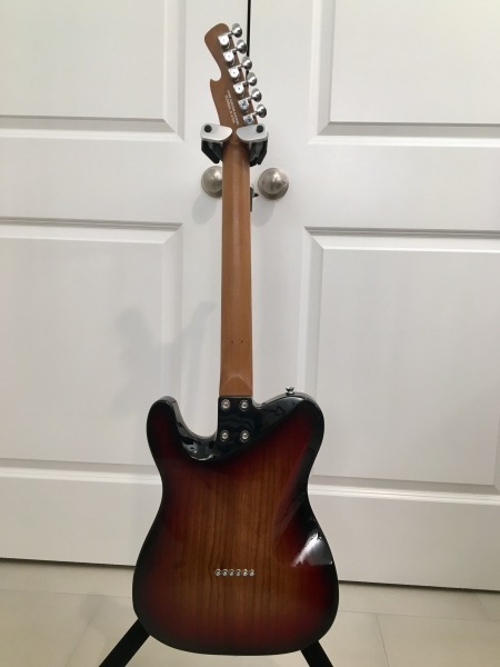

Here is my photo setup:
Here is the source image:
Here is the masked, straightened and cropped image (6000 x 3000):

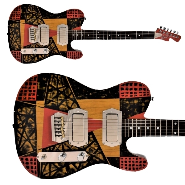

Here is the final (draft) collage for social media:
I noticed some masking errors on the image, so I will probably rework the GIMP file and save a better version of the image before posting it on Instagram & Facebook, but I'm pretty happy with the result as a first effort.

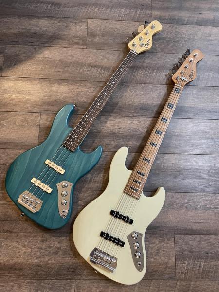

The blue and the cream bass are just so gorgeous!

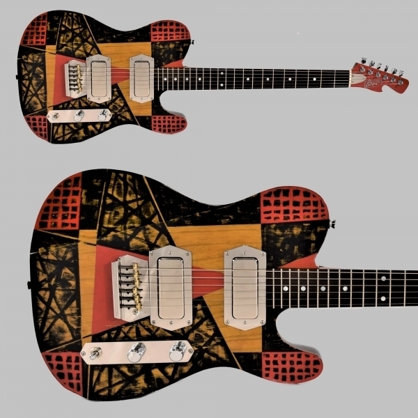

So, based on feedback, here is the same image with a better mask and a 25% gray background...I like it.
Thanks!
Thanks!
