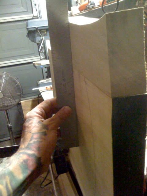

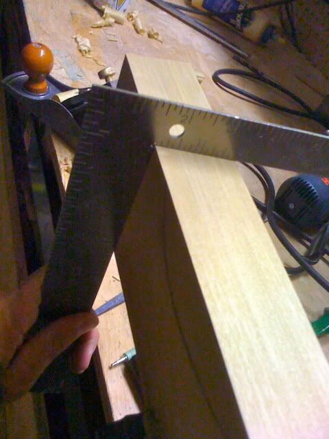

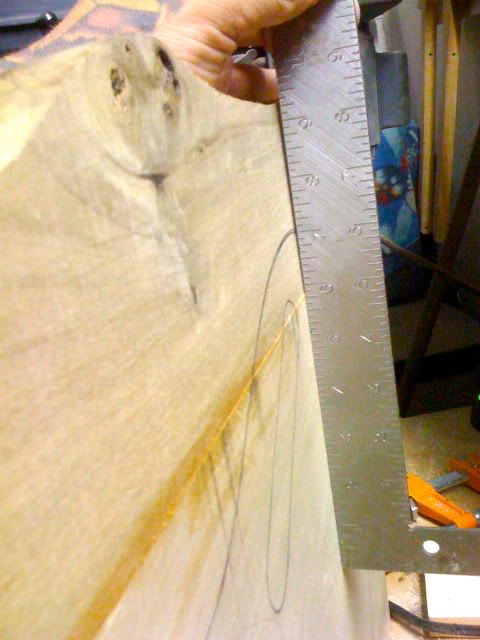

I was going to get the body done today, but I hit a snag and had to redo some stuff... When I joined the boards to make the blank, I made sure they didn't have any gaps, but I didn't bother to make sure the angles of the joined faces would add up to 180 degrees and create a perfectly flat blank...
In the past, I might have tried to build with that anyways, and try to sand the bump out of the joint. But now that I'm trying to get good at this, I took a stab at joining it again. If I screwed it up, the main piece is plenty wide to do a one piece Mustang (and I owe a Mustang body to Keegan), so I wasn't too stressed about this. Worst case scenario, I'd go buy more wood tomorrow morning...
I pushed the blank over my table saw right where the crooked joint was. I used my square to check the angle I was planing the edge this time...
It worked.
So now it's glueing up again. I'll probably start the body tomorrow and finish it on wednesday. Or start it wednesday and finish it saturday... I don't control my schedule; SHE does :squint:

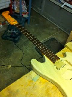

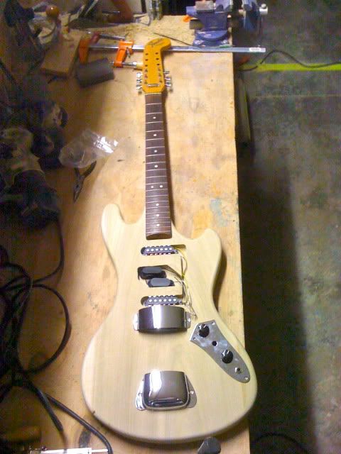

Hey Steve, do you want a gut cut on this? How bout an arm contour? And what positions do you want the knobs/switch on the plate (I'm gonna have to drill the plate for the switch) to be arranged?
Andrew, looking good! :w00t: I'd like both a gut cut and arm contour- it could probably stand to lose the weight!
I like the knob/switch/knob arrangement I did on the latest photoshop image.
Man, I'm psyched! ;D
P.S. I'm thinking just stick that chrome "finger rest" between the "woulda-been bridge cover" and the bridge.

Out of sheer morbid curiosity- what's the total length of that bad girl? Something tells me she WON'T be neck-heavy! ;)
And how's about a mock-up pic without the chrome covers too?

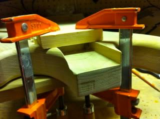

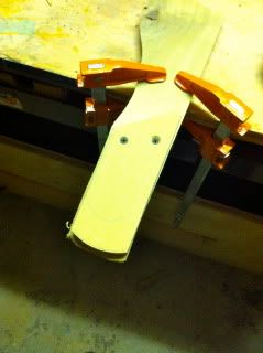

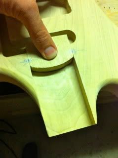

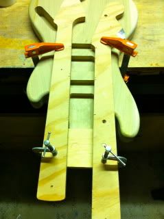

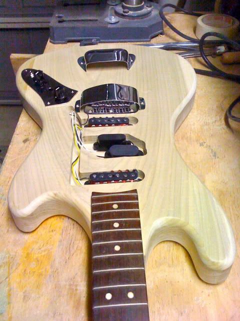

So, you might have noticed the gap between the back of the neck pocket, and the oddly-shaped heel. If this was my guitar I'd leave it there and claim I did it on purpose for truss access, but since Steve has been SO effin' on top of his game with this build (sent me EVERY part immediately and hasn't shown a sign of even one excuse or problem) I thought I'd make this build my best yet ;)
I started off with a pair of templates, clamped and double-stick taped in place, and I routed out the area between the neck pickup and the neck pocket.
Then I traced the heel onto some MDF and cut/sanded a template to make the plug dealie by flush-trimming a piece of scrap poplar that had been planed to 5/8".
I trimmed the end off of the scraplar to make the plug deal. It is so snug! I planned to epoxy some gaps, if there were any, but I even need to. This fit is flawless ;D
Fits like a glove. After I cut the pickguard, using the pocket to shape part of the pickguard, I'm going to trim out a truss adjustment hole (seen sketched on here) with my router...
Now it's all glueing up. I'll probably do the test string and pickguard tomorrow, if not, for sure on Monday.
See that hideous blemish on the heel? The bearing exploded on my router bit right there. If it happened any where else I'd have to fill it, but where it is I can just sand the heel down probably even 1/16" to fix it...
