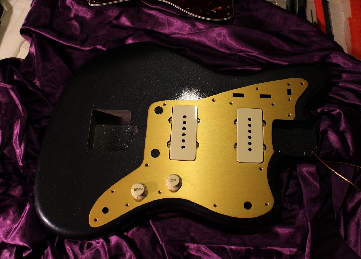

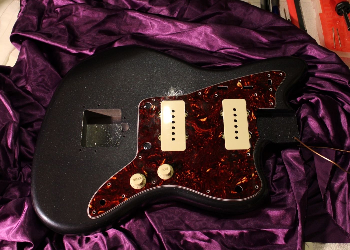

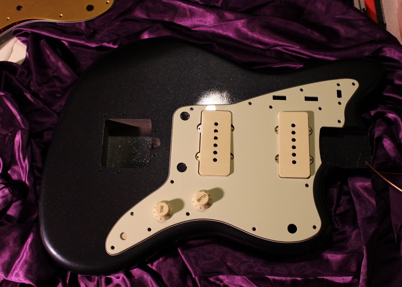

Not quite done with the clear lacquer, but had no time to spray today. Hopefully this week I'll unload another 8-10 oz and that will do. In the meantime I couldn't resist but take some late night photos testing the pick guards. The mint one (not showing the color properly) is one of those inexpensive notorious easter egg green ones that has spent a week under the hot early September sun, and actually it has lost its yucky green color and has faded a bit, but I am hoping for it to start to yellow and then it might be a good one tho use. While the lacquer dries, this pickguard shall remain outside on the sun and other elements - on the south side of the house. BTW, I am not considering the swap the places of tone and volume pots. :derp: :wtf: :fp:

gutter rock wrote:Yeah it may be too blue for what I am aiming for. I bought a couple of duplicolor grays as well, need to shoot some on some scrap wood and make a decision. Your guitar looks great though! I have enough blue guitars as it is so I am thinking more gray now for sure. Big thanks to this thread, tired of agonizing about it.
Yeah, testing is the way to go. Nothing beats that. Btw, the gray I tested (on page 1) is called dark Shadow Gray, also a Ford color.

Looking great. Diggin the tort personally. Nice project.

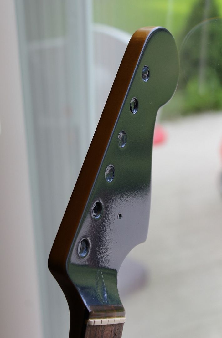

Tape worked pretty well:

Post by s_mcsleazy » Thu Sep 10, 2015 1:00 pm
mint with black pickup covers/knobs

s_mcsleazy wrote:mint with black pickup covers/knobs
This
This
That would look great! Definitively thought about this last night as I was shooting the photos. Might need to get a set of black covers.

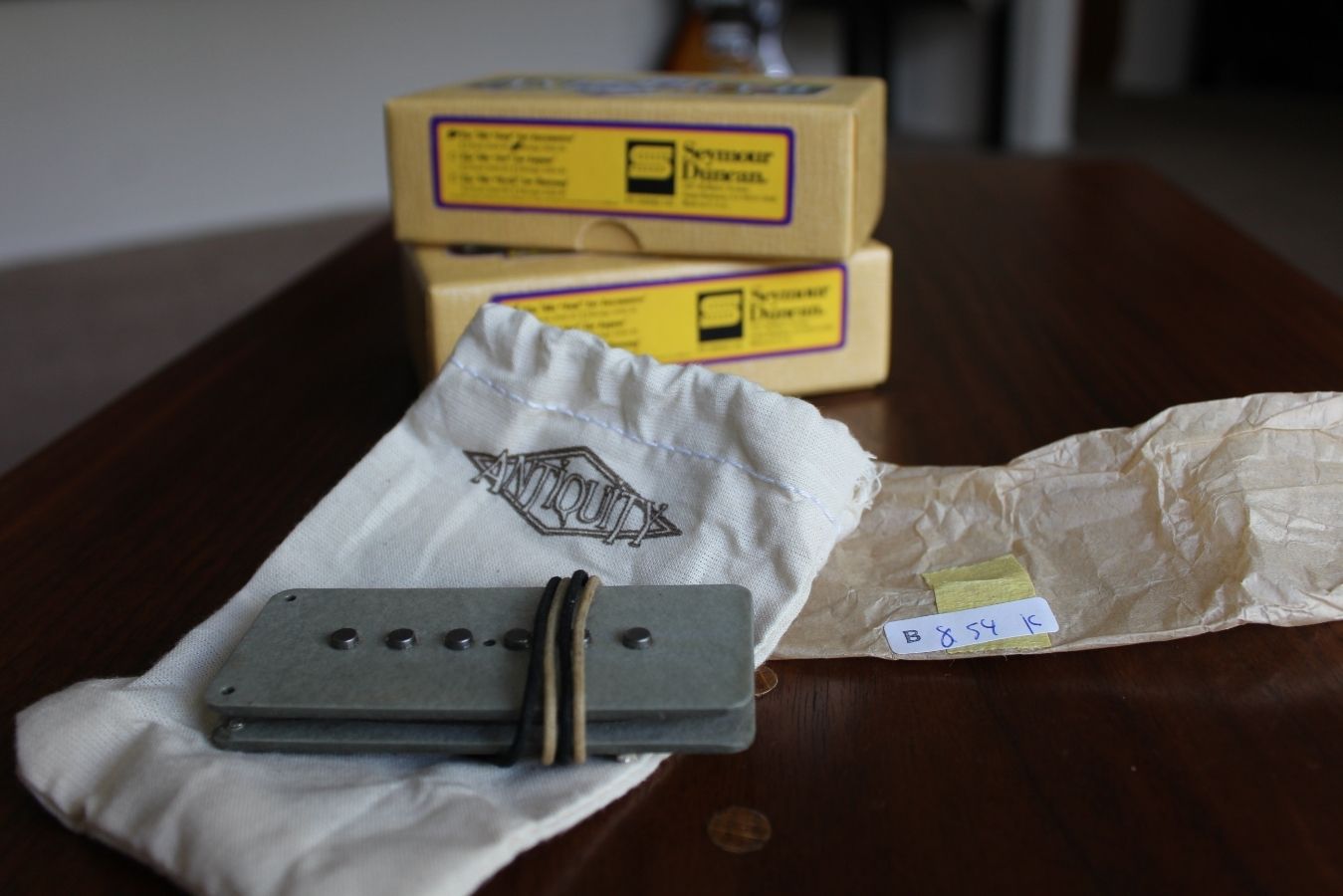

Pups are here! I was able to find a second-hand but new (never installed) set for a good price.
