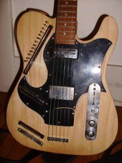

so i'm working on my electric sitar tele, talked about here index.php?topic=6112.0
and i've got it strung up and everything, but i'm noticing the sympathetic strings are not resonating as well as they were on the original cheap plywood rogue. now i realize that a solid block of tonewood is not going to have the sympathetic vibes a thin top will, so i'm thinking about making the tele semi hollow. if i do it i'll do it rickenbacker style where you route out the body till its a shell then glue on a thin top. i'll leave the body solid where the 12 zither tuners are because i doubt the thin top would support that much tension. ditto where the string anchors are.
i'm wondering this
A will this method of construction give me the sympathetic vibration i need to drive the extra strings? or will it be too dampened by the thick sides of the body?
B will i lose the sustain that i have now on the main strings when i don't have the body mass i do now?
C what kind of top do i need? i'm assuming it has to be a solid piece of wood, not bookmatched pairs if i want to get good transmission...
anyway, any help would be great!
i'm wondering this

nope, the sitar "buzz" bridge has been the constant in both guitars. it is of course still "soaking up energy" but on the solid tele body i can let the bass notes drone. that was really hard on the original setup.djetz wrote:dain wrote:
As to why the original guitar didn't sustain - I expect the "sitar" bridge is the main cause. It's dampening the vibration of the strings, soaking up energy (Newton again), so it will never have as much sustain as a regular guitar bridge.
the strange thing is i'm not really talking about "resonance" i'm really concerned with "transmission" i wonder if they are separate enough functions to need different techniques . the main difference between the electric sitar and a real one (among many things) is the fact that on a real sitar the sympathetics are running through the same bridge as the main strings. this is awesome because it couples the two sets of strings. unfortunately, i don't have that so i'm wondering if i need to concentrate more on transmission issues. i.e. linking the bridges versus linking the string anchors.
i'll have to work on the soundhole placement...here's what i'm working with now...
http://i165.photobucket.com/albums/u47/ ... IM0713.jpg

Well, it's entirely possible that a badly designed/made guitar will actually dampen string vibrations in unpleasant ways, so putting the buzz bridge on a different body - moving it from a crappy semi-solid to a decent solid - will increase sustain if that's the case.dain wrote: nope, the sitar "buzz" bridge has been the constant in both guitars. it is of course still "soaking up energy" but on the solid tele body i can let the bass notes drone. that was really hard on the original setup.
