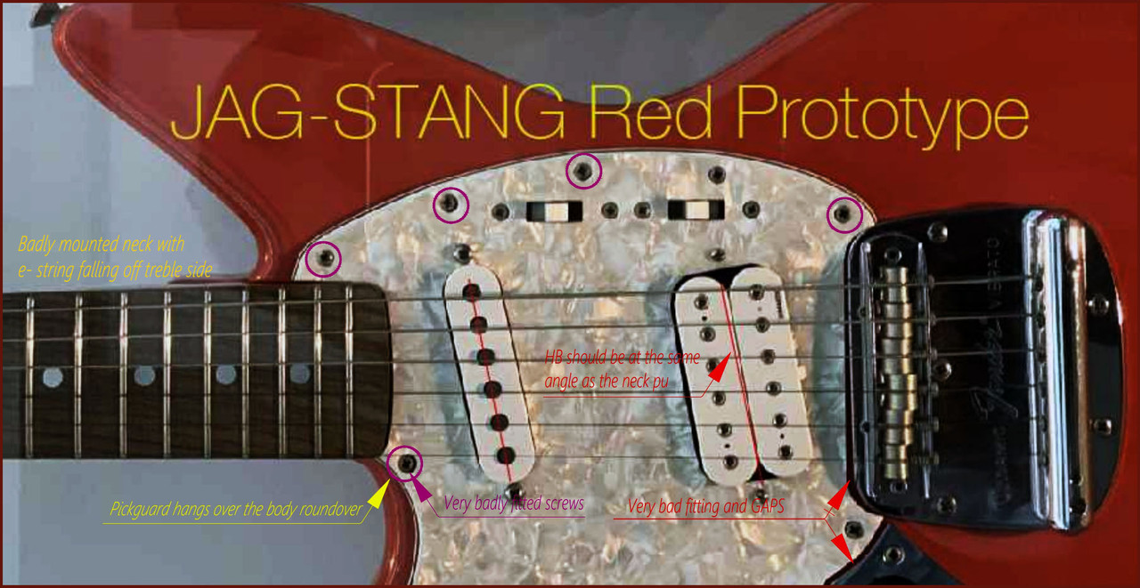

What I’m seeing on Red is:
  • A less refined shape;
  • The pickguard is crudely cut and mounted at an angle with screws forced into position;
  • The lower horn and the pickguard are not mating each other;
  • Contact points between pickguard and metal plates have CROOKED gaps;
  • The neck is mounted well south of the central line, so much so that the high e-string is dangerously close to the edge of the fretboard;
  • 5 screws instead of 3 at the top of the pickguard.

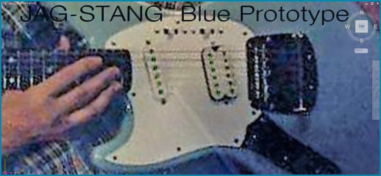

Now, look at this picture below and pay attention:
There’s indication to a detail I haven’t put among the bullet points.
Take a closer & deeper look. Spotted?
Do you remember I mentioned my constant feeling of something being off?
A memorable quote comes to mind:
“just because you’re paranoid, don’t mean they’re not after you” (Nirvana – “Territorial Pissings”)
Well, if you spotted it, congratulations, you’ve got the detective eye.
For those who didn't, the answer is: the mismatching angle of the pickups.

And it wasn’t just Red’s mismatching pickup angle.
More crossing evidence and other intersecting anomalies were putting Red and Production Model on the same path. Actually, right on a rail-crossing to be precise.

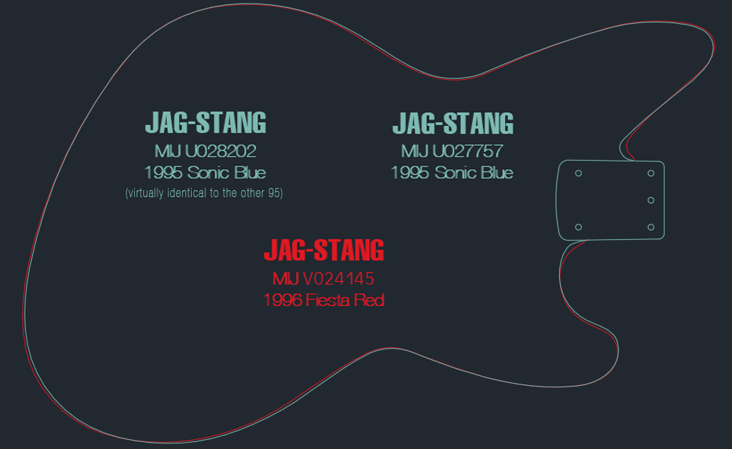

Again, I wanted Math to speak its voice.
We learned the hard way how much pictures can be deceiving and I wanted to triple-check the data before making any bold statement.
This of course required to find a Production Model JAG-STANG of each generation to be digitally traced and furtherly analysed.
Whereas our very own Patrick Cross kindly came to the rescue and pencil-traced the template he made off his 2nd gen MIJ 1996, founding the owner of a 1st gen of MIJ 1995 was actually a rather difficult task.
It took me almost 4 months of research, but the OSG community has proven to be great & very friendly as I have in fact ended up having not 1 but 2 owners willing to trace their guitar and taking the measurements I needed to translate them into vectors I could study.
The incoming analysis is therefore based on these actual JAG-STANGS:
MIJ U020117 (1995) Fiesta Red – courtesy of Patrick Cross
MIJ U027757 (1995) Sonic Blue (vectorised) – courtesy of Michael aka “jagstang”
MIJ U028202 (1995) Sonic Blue (vectorised) – courtesy of Paul aka “Acidhouse”
MIJ V024145 (1996) Fiesta Red (vectorised) – courtesy of Patrick Cross

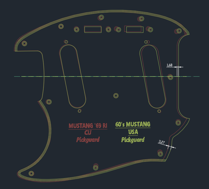

Moreover, I’m gonna show you why you get a positive match with USA specs and a negative result with Japanese specs.
My first approach was to use what I had at my disposal, which was only the hi-res JAG-STANG picture taken off the internet and my own CIJ Mustang 69 RI.
After all: “Close enough is good enough”, right?

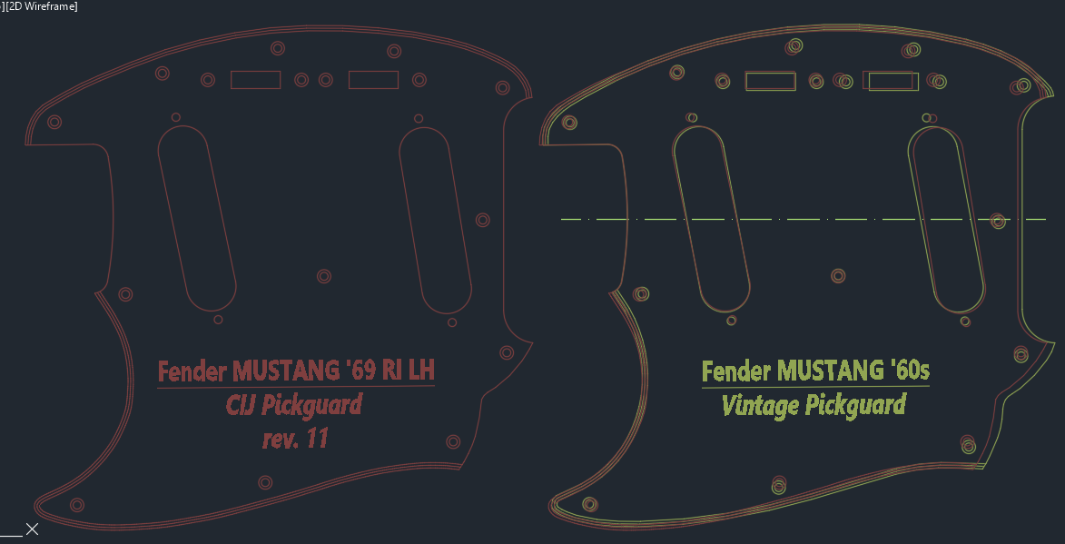

Well, it is unless your OCD kicks while you’re digitalising a Vintage 60’s Mustang pickguard and you spot that 1mm-something "variation on the theme".
There you go: USA vs Japanese:
It might not look a big deal in the great scheme of life but, on this particular occasion, those few millimeters here & there make for a dramatic difference if your calculations are based off the wrong foundation.
First foreseeable result: putting a Japanese guard on to replace a Vintage equipped body means you’d get gaps.
Let’s disregard the lower section entirely as for Larry basically wing it, what matters in the retro-engineering are:
  1. The horizontal length from neck pocket to the dynamic vibrato plate;
    2. The placement of the control plate cutaway.
Point 1 is marginal at this stage, but I can guarantee that point 2 is the Ruler of the entire body offset geometry.
If you were to shape the lower body cutaway based off the Japanese guard, you would end up with a majestic issue:
  • The lower body cutaway would end-up placed closer to the neck, resulting the entire offset axis being non-parallel with the angle of the pickups.
    On the contrary, by using its USA counterpart, all the proportions match the photographic data and also, the angle of the body offset gets completely parallel with the pickups angle.

Enters Patrick’s MIJ (2nd gen) 1996 JAG-STANG pickguard, let’s go:
It’s dead-on.
I have also tested a pickguard from a 1st gen 1995 MIJ JAG-STANG and the result is exactly the same: the bridge pickup is tilted backwards just like the MG69 RI
Now… Are you guys surprised?
Do you know what are the implications? Have you seen THAT ANGLE somewhere else before?
Don’t tell me the bell hasn’t rang yet…

Alright, let me show you this USA-spec American-Made Blue Prototype and its angles:
…and now compare USA Vintage accuracy against this USA-spec American-Made Red Prototype:
Interesting, isn’t?
Don’t worry, there’s more….
As a confirmation of the visualised differences , here’s an overlay of the vectorised version of 1st gen VS 2nd gen JAG-STANGS:
(the two JS 95 are so similar to be virtually identical, I put only one tracing for visual clearance)
It’s time for an updated recap:
  • We know Larry built Blue and Red with USA specs of his Vintage Mustang;
  • We know the final shape was followed by an aluminium CNC template costing Kurt 8.000$ each;
    If we count two shapes, Kurt paid 16.000$ only in metal templates without considering all the other processes involved during its development;
  • An aluminium template doesn’t shrink as old nitro pickguards do. If it’s made with USA specs, it stays that way, it won’t morph;
YET, we get all these contradictions:
  • For some reason, Red shows all those many peculiarities of MIJ specs;
  • The Production Model itself, as early as the very first ones where made, are MIJ specs even though we know Fender had the aluminium CNC metal templates with USA specs;
  • The Production Model itself undergoes some further revision at some point in 1996;
  • The Production Model looks like it has no real 1:1 replica;

Red is the constant anomaly in the whole picture.
Are you thinking what I'm thinking?
I don’t read minds but I can assure you that me & AcrylicSuperman came to the very same conclusion:
“Could it be that something happened to Red that required some replacements?"
"(Or do we really have to think it is actually…. Wink-Wink).”

We see that along with the change of shape, there’s also a direct jump of serial numbers from U to V happening exactly from 1996 onwards.
The last MIJ 1995 on that registry is a Fiesta Red listed with serial U999999 but description shows that the decal was scratched off and the owner doesn't know what the actual serial was.
So far, none of the 95ers displayed a V serial.
The first V serial on that registry is a V000501 from 1996 though.
In this page you can insert your serial number and get the dating.
