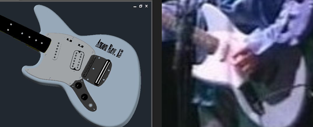

Amon Rev. 13
Exhibit E:
Focus on the pickguard's bottom shape and the silhouette of the body all across lower horn---> bottom cutaway----> control plate. Seems to match.
This pic also is one of my best reference for the body thickness AND, if you look closely, you see ONLY 3 screws on the upper side of the pickguard.

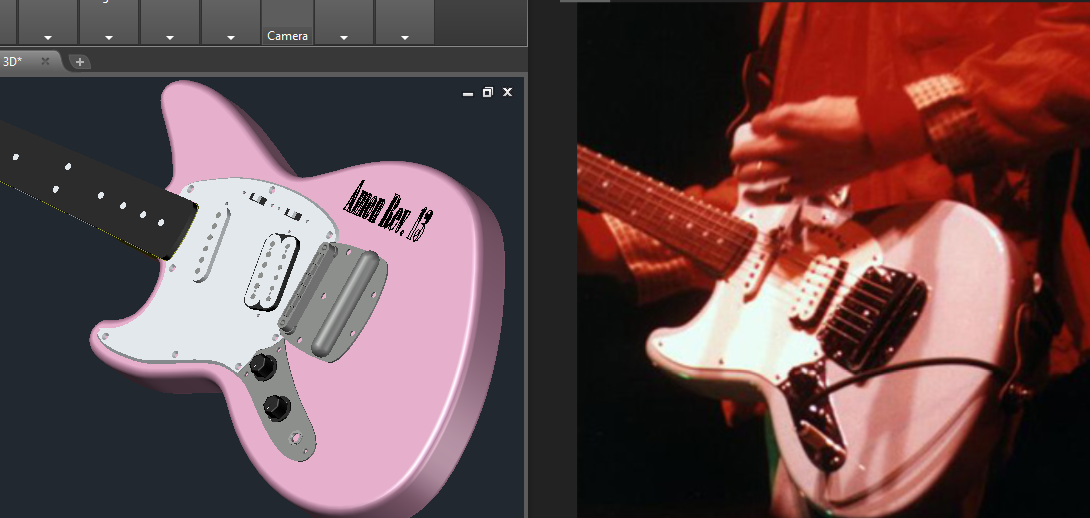

Exhibit F:
Still focus on the lower side of the guitar. A further close-up of the lower horn. Its thickness, the body radius and the control plate area. Seems to match. (Top horn seems to be off... Bear with me for a bit)

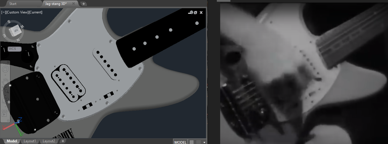

Exhibit G:
General guitar outline... all seems to match..
YET, it looks like the top horn is off by a lot. Said horn has been a major PITA, as it looks different in almost every pic.
In this specific one it looks like the inner cutaway is waaaaay straighten than it actually is.

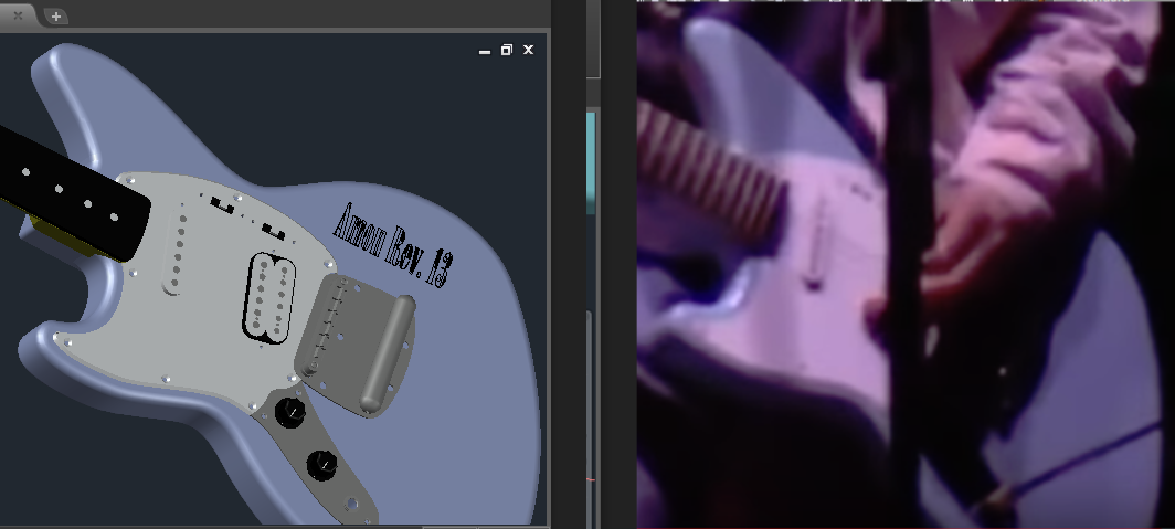

Onwards, this next one will give you an idea of how much I had to fight against lighting and bloody perspective distortion...
Exhibit H:
Keep in mind it's always the same rendering, but the reference pic is from a different show. Now we're seeing the bastard -the top horn- in its true shape (both inner cutaway, outer silhouette and tip).
Do they look
similar now, right?
Damn perspective and lights..
Now render and actual thing look rather matching, what do you think?

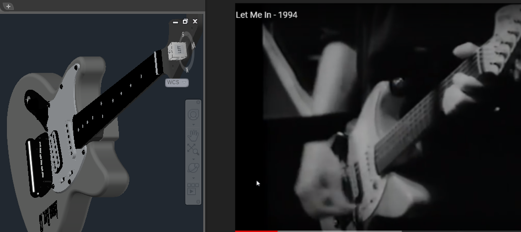

Just because I can't help myself criss-crossing things to see if I'm on the right tracks and not misled... I had to do some other confrontations... hence... let's see if this horn behaves the same from another angle...
Exhibit I:
Well..
kinda looks like they are still matching accordingly..
But now my eyes noticed 2 things:
1) yes, the already mentioned 3 screws in the pickguard instead of the standard 5 we have in prototype #2 and production models;
2) the edge of the pickguard looks dangerously closer to the cutaway than what I see in the render... I HAD to triple-check (x100, if you wonder how much I did it in reality) what was going on... so...
