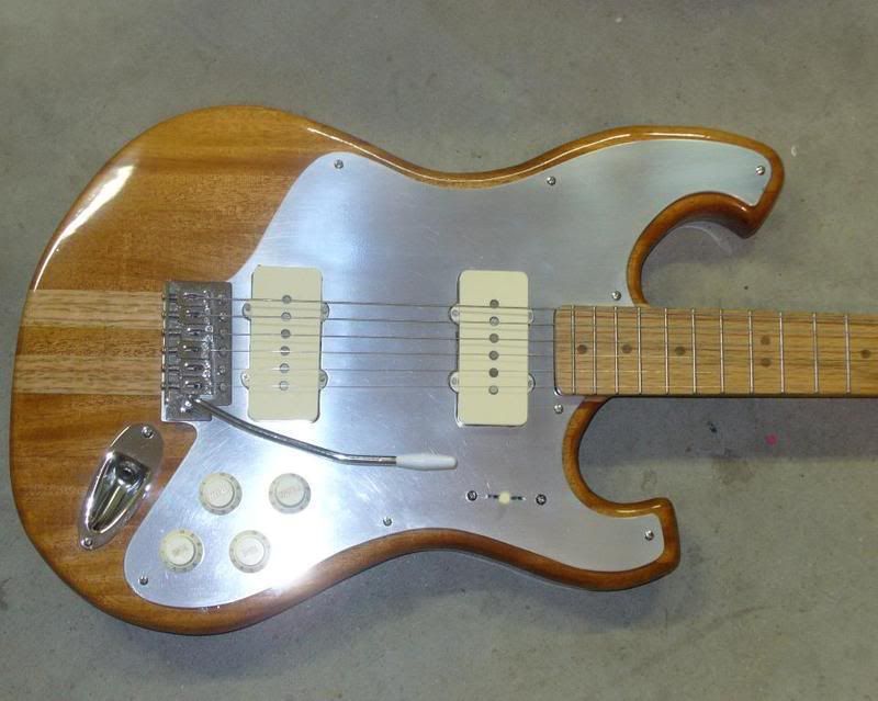

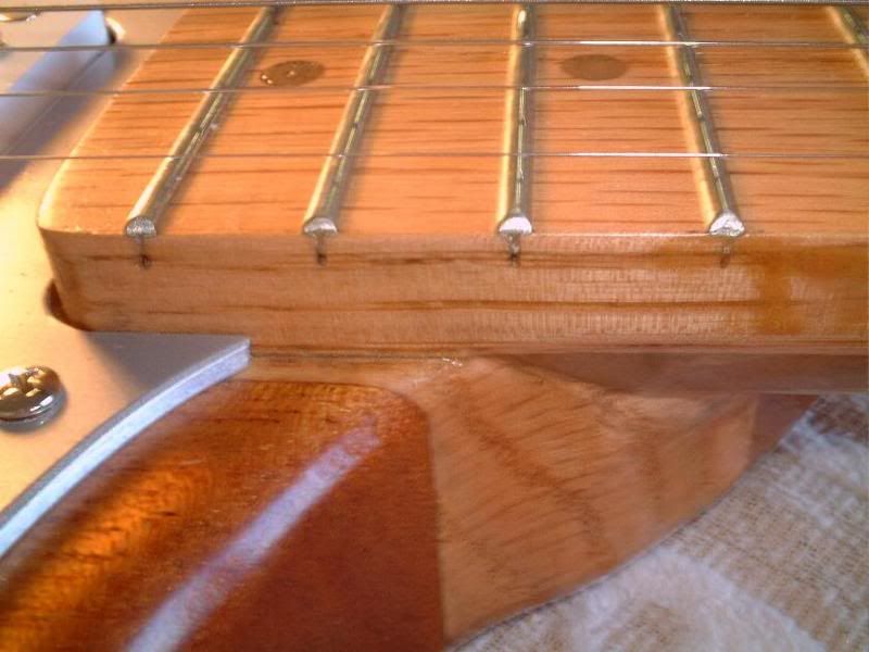

Check this out.
I made one from mahogany 'sticks'.  27 coats of nitro and an aluminum pickguard. I don't think it looks to bad.

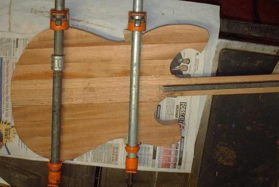

Gluing the body and through neck together

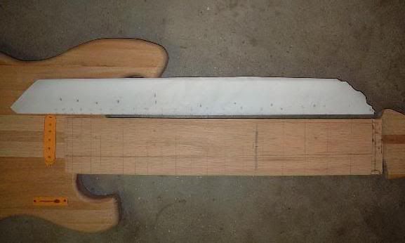

Marking the fretboard for the frets

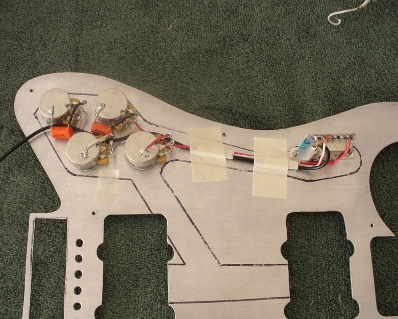

Electronics going together
It was a little easier then I thought it would be
