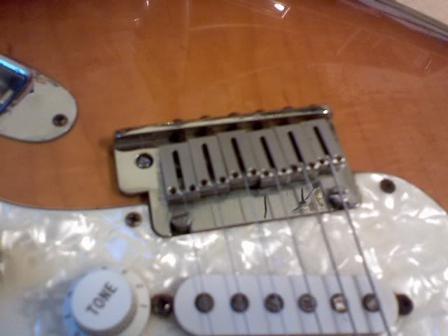

I can't for the life of me figure out how to do this!!!  >:(  There's no access hole in the back.
I tried to drill it out, but then the bit broke and this happened  :(
I'm a bit frustrated here.

Remove the tremolo springs from the block.
Separate the block from the bridge plate/saddles.
Once you do that, the block should fall out of the guitar.  The broken bit of the tremolo bar will still be lodged in the block, but it will be a tad bit more exposed.  Grab the nub with a pair of pliers and twist.
I've had the same thing happen on my Strat...
...several times.
thanks for that.  I didn't realize they were detatchable

Tommy,
You probably have to use a screw extractor which looks like a tapered drill bit with twisting dull flutes. How you use one is that you get a hole punch and punch a hole in the middle of the broken off arm in your trem block. Make sure you get it dead center. Then you drill a hole about half the diameter of the broken off piece. Drill down about 1/8" to 3/16". I don't have to tell you to be very careful and keep the hole centered. Then you use the correct sized screw exractor in a tap handle and you screw it in counter-clockwise. Eventually the screw extractor flutes grabs onto the walls of the drilled hole and the broken off section unscrews right out. I know, easier said than done. But since there is a broken off drill bit in the hole, looks like it's time for a new Fender Am Std trem block. Sorry about your situation.

Post by Tommy Horchata » Thu Feb 21, 2008 9:08 am
Tommy Horchata wrote:
I used this method last night and it worked perfectly
thanks for the help!  Who knew I would find the right Strat fix method on the offset forum  ::)
now off to the tech to get a setup done before the gig tonight!
