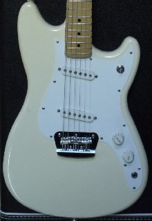

Here's my duo sonic. i'll never get rid of it.

Looks like you might have changed your guard to a 3-ply too? Mine is 1-ply but starting to warp.

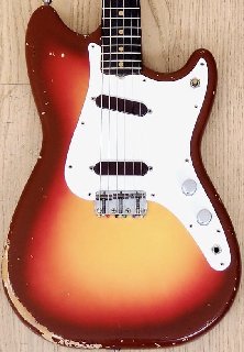

I've spent minimal time with the newer MIM series, so can't comment on them. But here's a crude comparison that illustrates the body size differences between the early MIM Fender/Squier Affinity Duo Sonic, alongside Vintage. I made the comment about the body size after someone brought up wanting to try a vintage Duo as a result of liking the MIM/Affinity style guitar, but my point is they feel like totally different guitars to me.MKR wrote: ↑Thu Apr 30, 2020 2:44 amthe bodies are not smaller at all. They're basically identical. There's a comparison video on youtube involving the 90s Mexican reissue and the more recent Mexican ones and side by side they're pretty much a perfect fit.Danley wrote: ↑Wed Apr 29, 2020 7:33 pmI’ve played vintage short/22.5” duos, and the MIM reissue. For what it’s worth the vintage necks feel like a ‘real’ neck but cut short; the MIM neck just felt too dinky for me. MIM bodies are MUCH smaller too, as there’s less pace between the strap button and bridge.
I’d look at the nut first for tuning problems. The stock cheap tuners can actually work fine even if they feel kind of sticky and shitty.
Because these images are equal sized vertically, the body size difference translates to one of proportioning; look how much less room there is on the MIM body between both the bridge and strap button, or between the strap button and input jack. I do concede I don't have both guitars to measure, but through the pic it is at least visible that the MIM is packaged in a more compact way; the MIM body looks shortened in a similar way to the later Mustang Special bodies, which had an inch or more of the lower bout chopped off as well:
