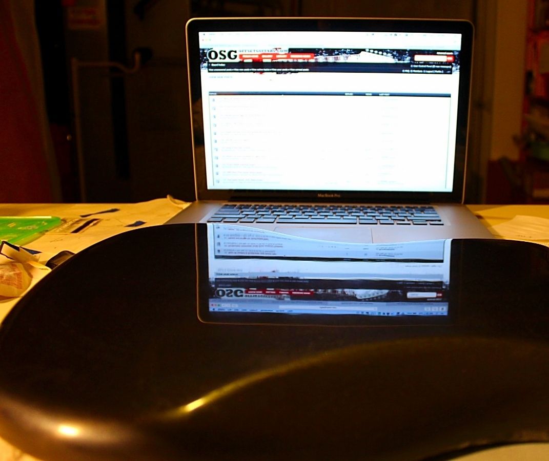

I had a very nitro day today. Sprayed some more clear on the body, probably enough for it to be left alone for a while and sanded to a mirror finish in about 4 or so weeks. Unless...

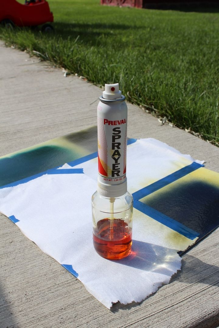

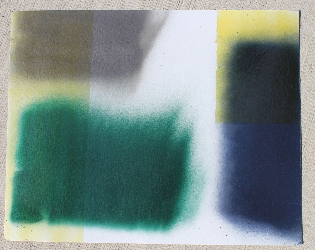

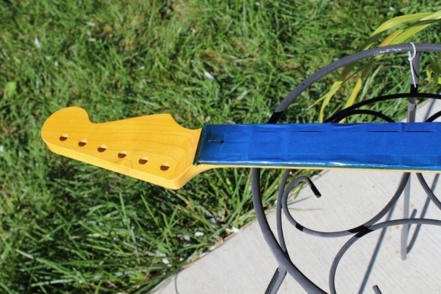

So while waiting between coats on the body, I was spraying amber nitro on an Allparts strat neck (white binding) that I had for two or so years waiting to become a project. I was using one of those Preval units. Tinted the nitro with some amber transtint dye. Then I remembered that I have the sheet of cardboard were I tested the colors. I wondered what would these colors look like if I hit them with a amber coat or two?
Result:

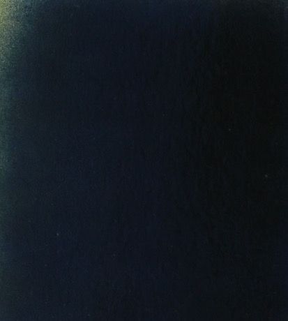

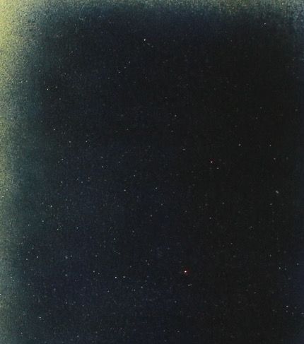

And it's almost a black.
Sun:
Shade:

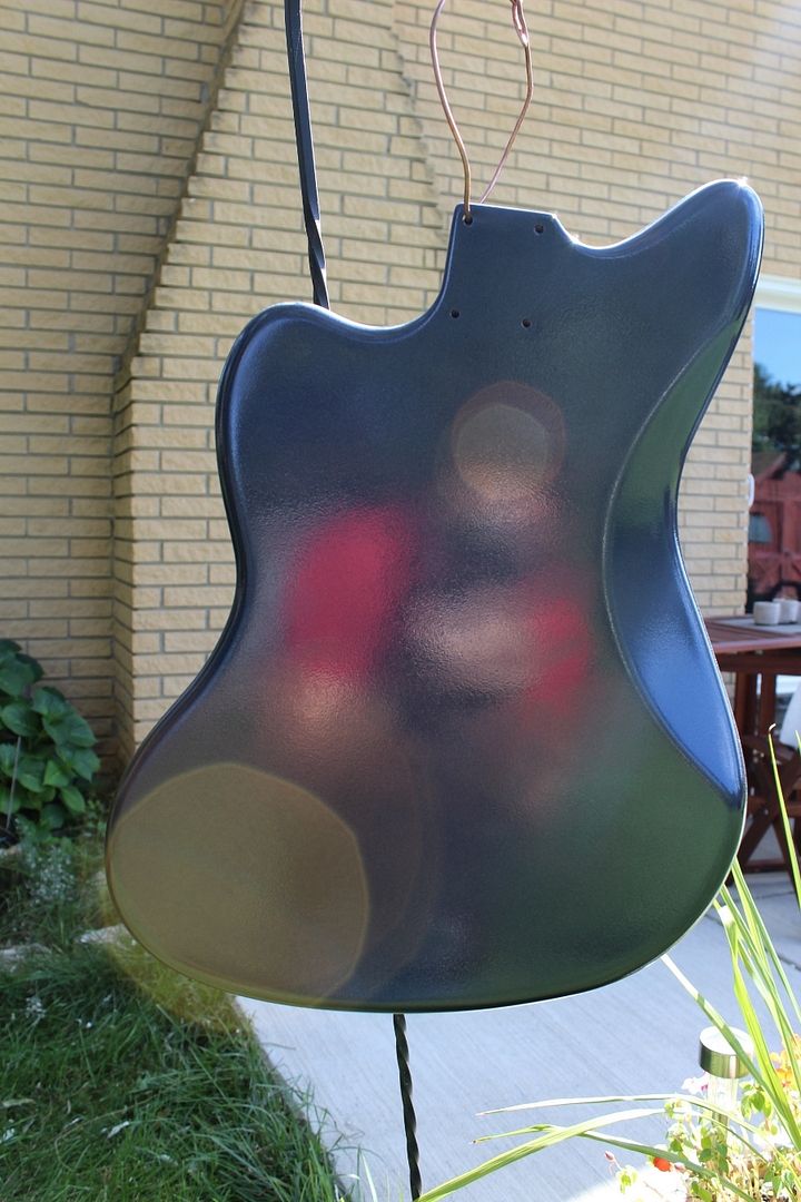

What say you wise people of OSG, keepers of all offset knowledge? Spray an coat of tinted clear over the current coat, i.e. push the blue-violet into bit more neutral territory, or leave it as is and not mess with it?

Post by Tweedledee » Mon Sep 14, 2015 10:28 am
I say leave it as it is. With the addition of the tinted clear it looks like it becomes too dark.

Post by AWSchmit » Mon Sep 14, 2015 10:45 am
I'd leave it too... You have a real nice shade going... I would, if it were me, use a top coat that yellows with age, just because I like that look once it has aged. But for now I would leave it clear.

You are all right. Don't know what I was thinking. It it was the grey color, I think I might have just gone for it. I think I need another JM body.

Post by PixMix » Sat Sep 19, 2015 10:13 pm

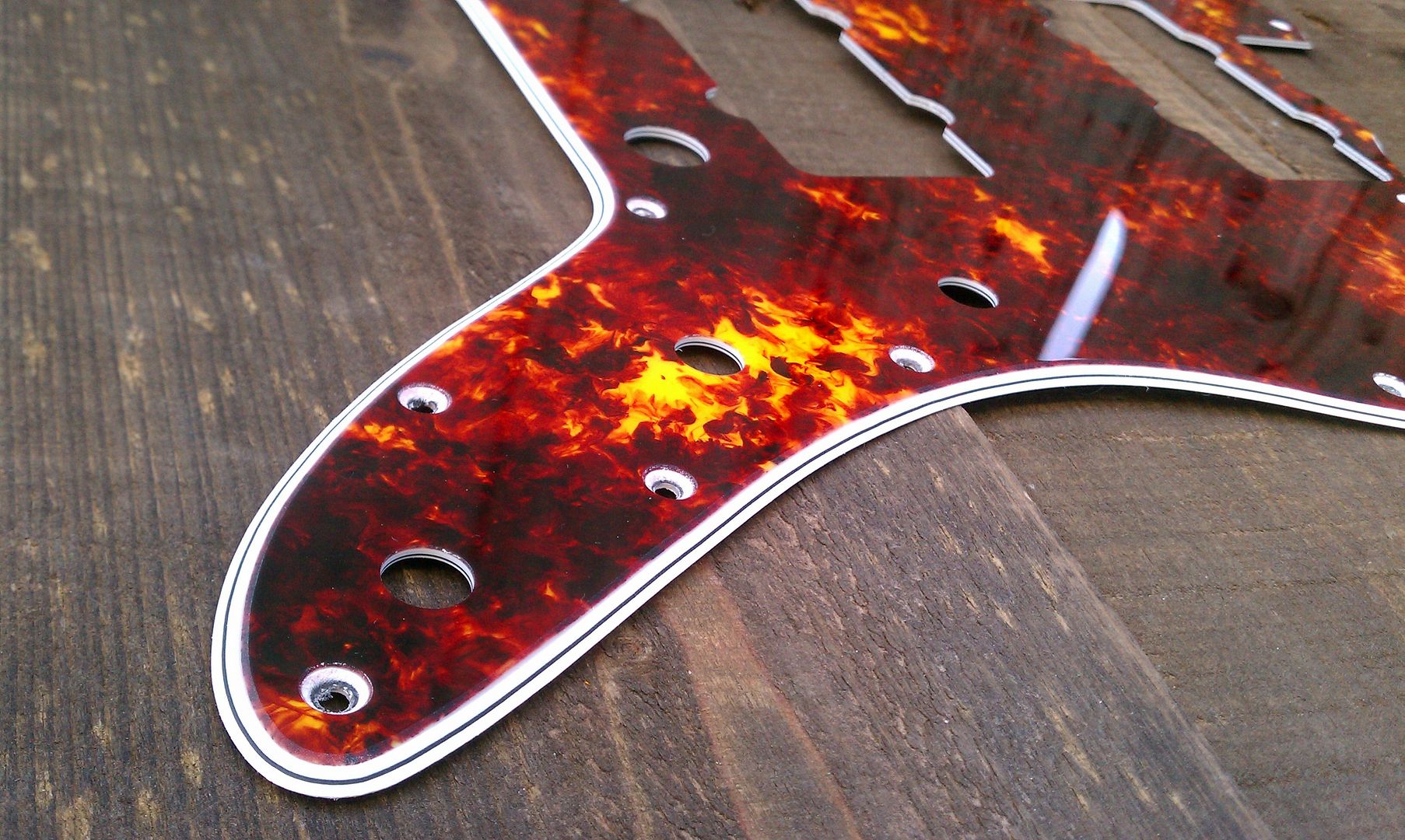

In the meanwhile, in the early morning hours of Sunday... (excuse the mess of the workstation)
...and a pg teaser
