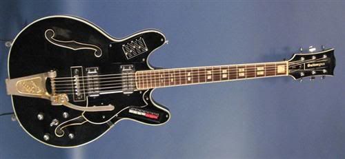

So, a friend of mine has had for years now, this guitar that he got for free (along with a 70's SG) that simply says GuitOrgan on the headstock.  Now I know a little about these, mainly the part about the outboard pedal that connects to it and generates an organ tone to the tune of the notes played on the guitar.  The frets are individually wired in six sections that cause an otherwise open circuit to complete when a string is de-pressed and send an electronic signal to the pedal where a sympathetic drone note is generated.  Univox made some and every one I've seen looked like a circuit-bending nut went to town on an ES-335.
I got to hold it and the thing weighed a ton.  It was gloss black and has a tiny red push-button by the nut of all places.  Anyway, we're hoping to find the pedal that goes with it or a schematic for one or somebody willing to build or repair one.  Anybody have any ideas?

Posts: 10672
Re: The great mysteries of... the GUITORGAN!
Post by Stereordinary » Sat Sep 08, 2007 9:56 pm
From Willie's:

stereordinary wrote: Now I know a little about these, mainly the part about the outboard pedal that connects to it and generates an organ tone to the tune of the notes played on the guitar.
actually most (all) of the tone generation equipment is in the back of the guitar covered by the large rectangular cover.  some models didn't even come with the volume pedal assembly they just attached to a box that supplied power through a multipin. you might be able to get by without the pedal if you just built a variable power supply.
Posts: 10672
Post by Stereordinary » Sun Sep 09, 2007 9:30 am
Got a shematic for one?  Or better yet, where to get one cheap?
